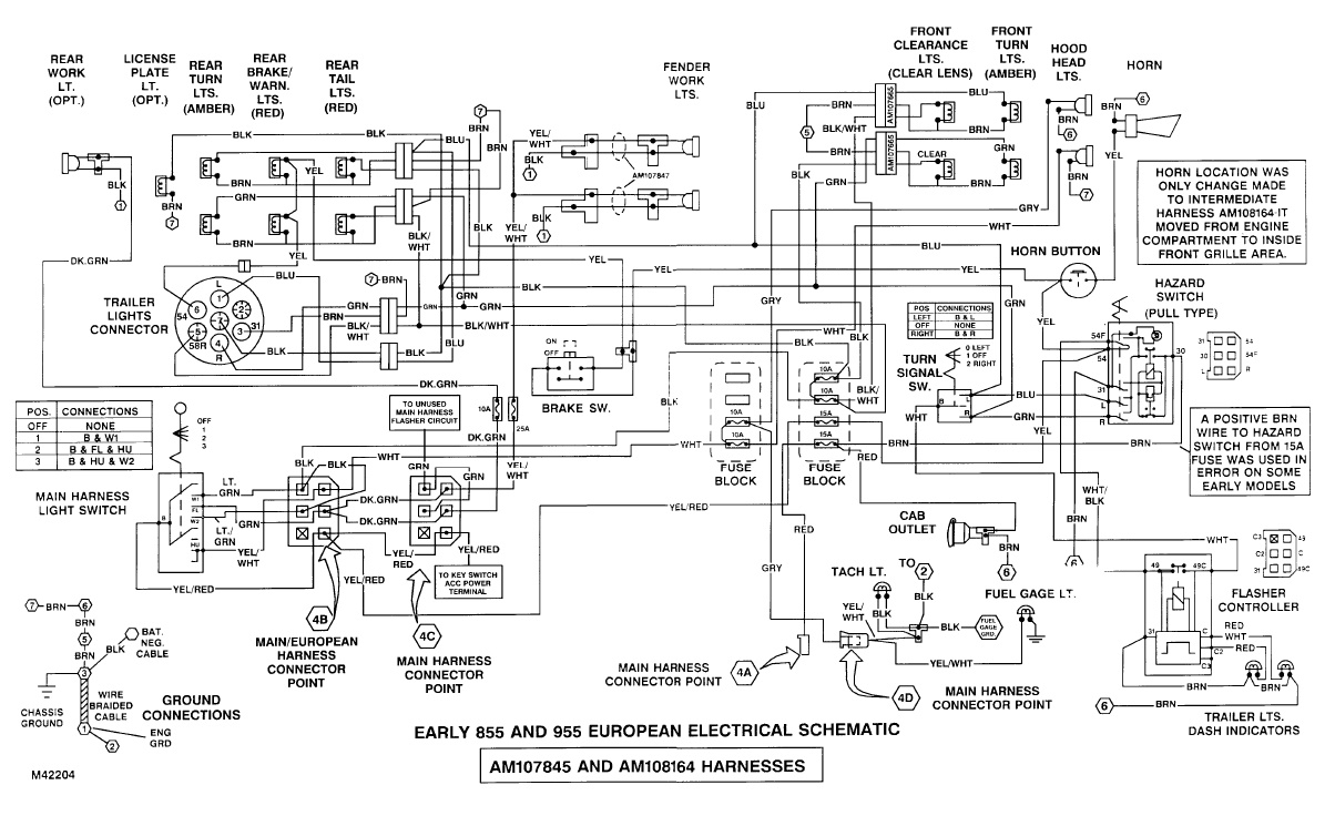

Hello All,
Just doing some investigating and wondering if any of you all have a Turn Signal Switch AM107654 installed on you x55 tractor?
I see it as item #31 in the JD parts catalogue but it does not show up in my IT Shop Manual wiring diagram.
Is this for the European models only?
I also see a 12V outlet, Park light switch, and Hazard switch in the catalogue.
Can somebody please enlighten me.
cheers,
John
   / Turn Signal Switch #2
It may be just EU. I didn't see it except on this EU page on the tech manual.
