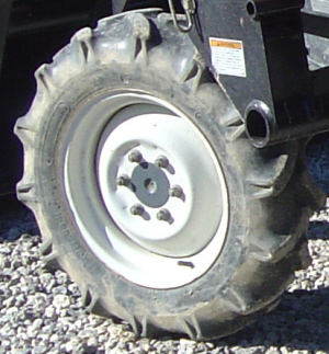

I have a grey 'Bota, not sure if they will make a diff. or not but I thought I should state it.
Anyway, I live on a pretty good sized hill and the front lawn is pretty steep. I generally try to mow up and down but with the rice tires after it rains it doesn't do so well so I go across it. The pucker factor definitley goes up a notch but I haven't had reason to worry yet. I was looking at the front wheels tonight after mowing and noticed they look like they can be "turned out" to give me a wider stance. When I was looking to buy a tractor a few months ago I posted a picture of an Iseki TA that had the front wheels turned out and someone replied that the wheels should be "turned in" (narrow stance).
Am I missing something here? Wouldn't it make sense to make my front tires as wide as possible, like I have with the rears? Or are the front wheels not designed to take that kind of load?
PHOTO ATTACHED

Some manufacturers state that you can turn rims dished out to get a wider stance. CNH is like this. All the ford/NH units I've owened.. show dishing the rims for width.. however.. take cub cadet. A friend tells me his manual says that rims should not be dished out, that it places too much stress on front end components. ( guess they don't build them as strong as CNH units /forums/images/graemlins/shocked.gif /forums/images/graemlins/grin.gif ).
Also.. some rims are rigged with offset notches to prevent dishing.. etc..
check your manual..

I swapped my front wheels side to side. This increased the track 3"-5". The increase is due to the way the wheels are dished. A side to side swap may work for you, if the inside dishing is deeper the the outer dish.
My Deere 790 manual recommends this in some circumstances. The tractor does feel more stable, but that is subjective.
The side to side swap is required because R-4 tires are directional (designed to give more traction in one direction). Those "rice tires" you mention are closer to Ag type tires, also directional (assuming you have 4WD). A side to side swap may work for you. Only down side is the valve stems would be on the inside as mounted. That's a bit more hassle to check air pressure.

</font><font color="blue" class="small">( Also.. some rims are rigged with offset notches to prevent dishing
Soundguy )</font>
Yep, I looked a bit coser and sure enough the surface that would mate with the axle has raised sections to prevent you from turning them around. I guess that answers that.

The manual for my 4wd L4400 says not to do this with the fronts. It also says no liquid ballast for the fronts.
