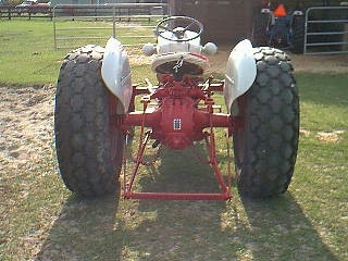

I've ran my tractors ( with ag tires )all over my pasture and front yard, and have only printed in in areas that were just dirt.
In fact, I do have a Ford NAA with turf tires on it, and it is similar in weight and HP to my NH 1920 with ag tires on it. I once used it with the box blade to push up the maneuer pile, and was spinning tire due to lack of traction. I had to switch to the NH 1920 to finish pushing up the pile. I was actually doint more damage to the edge of the grass around the pile due to the spinning.
And these weren't small turf tires either.. they had a good amount of ground contact.. they were 16.9 x 24's
I'll post a pic
Soundguy
