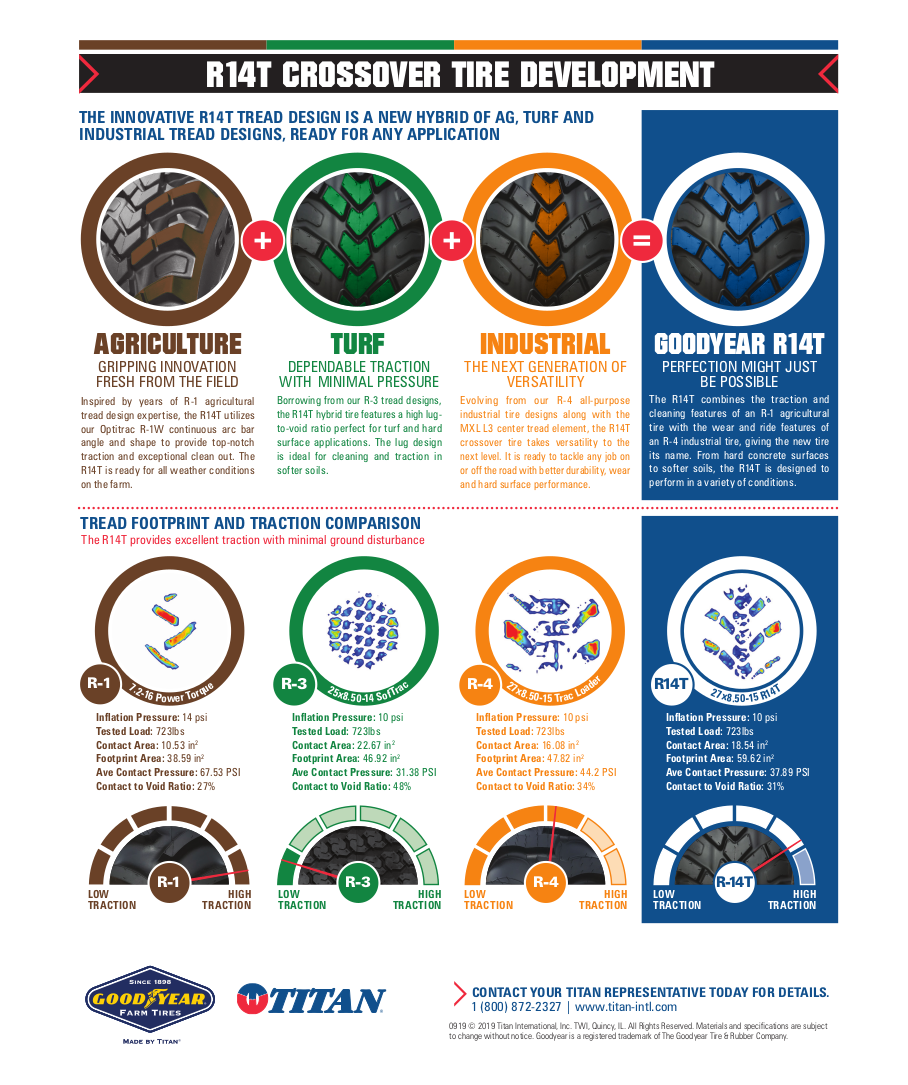

Yes you need new Rims - you can find them used sometimes if you have time wait and look around. If your going to change you might want to look into R14 which is a newer version of the R4 - the R14 take different rims I believe too. Contact a Kubota dealer for fitment to get the right sizes F and R.
   / Turf to R4 #3
I do like the R-14t tires. They are a cross of the R1, R3, and R4.

The R14’s I bought for my JD4720 fit on the factory R1 rims so I don’t think it’s as cut and dry on if you need new rims or not.
I love the 14’s.
