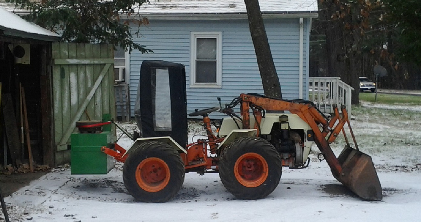

YES, I would chose the weightbox over any other implement, also gives you more clearance when backing up & turning.
Found that out myself this morning in 10" of heavy-wet snow, 6.5ft grader blade at 150 lbs, in place of the 1000lb weightbox, I miss my weightbox! I'm running 15.5" wide terra-tires, without chains & wheel traction is fine up front, but almost nothing out back & highly noticable.

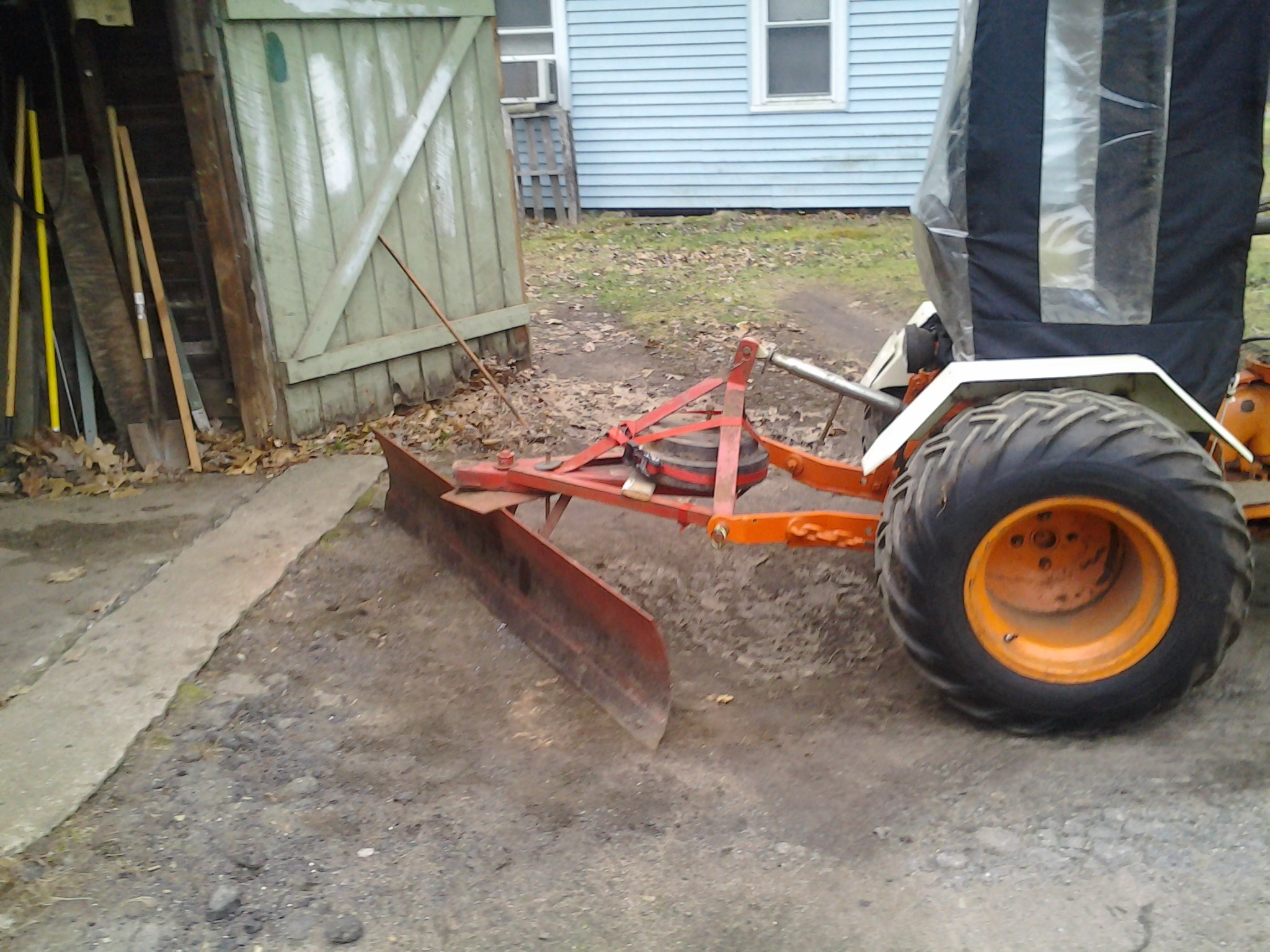

This is what I used this morning. I "HAD" to mount a 150 lb concrete ballast to my GB, just to get the 3pt to drop when in float. Without it it took forever unless I idled-down, and it still wasn't enough ballast out back. Pushed a pile of large stone across a muddy-surface this fall with no traction issues when weight-box was on.
Shadow

Shadow, mine does not stick out quite so far ..but reminding me -that the bugger is back there swinging around- is too distracting for me. I can only handle just so much concentration (pressure) at one time. ...that articulated rig you have looks pretty cool. If I was behind the wheel my drive would look like a lizzard cleared it.

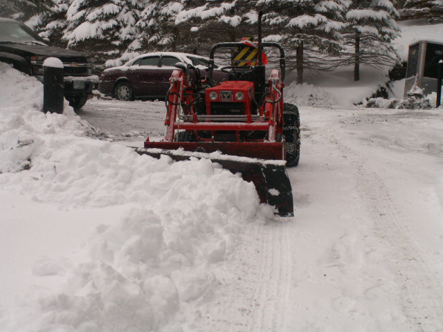

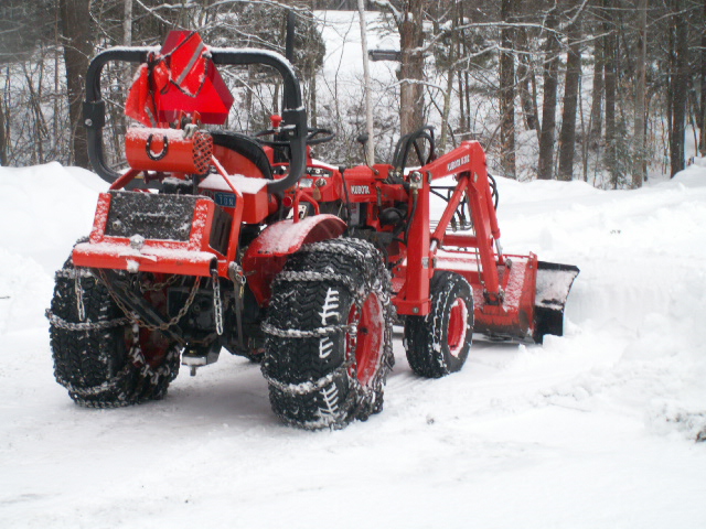

Since handful of storms each how about set tire chains..night & day when it comes to to turf tires pushing.

Weight box?? Put a backhoe on the back, it's the ideal ballast!
You get the right amount of weight on the back, and you won't have trouble plowing.
I plow on gravel with turfs, and have no trouble doing it.
Looks like the loader hanging up there is giving you a forward CG, taking weight off the rear wheels. For now, you would be better off without it.
