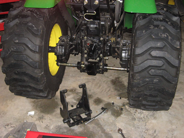

Here are two photos that I located to show the differences in tread between R3s and R4s.
Bill on the left are R3 (turf) tires. On the right are the R4 tires
Hope that helps

For the uses you have planned I would look at the R1's and R4's. R4's have a better load rating which is great for loader work and also have the best sidewall strength. R1's aren't as strong as the R4's, have a narrower track (more traction due to more weight on a smaller area) and dig in fast in the mud. R1's are good at burying themselves fast in soft ground, I have experience with this on a 1986 Yanmar. R4's have a wider tread pattern which allows for more flotation and wont tear up your yard as bad as R1's. They offer good traction and traction can be improved by filling the tires with antifreeze and or adding rear wheel weights to your machine. Hope this helps. :)
