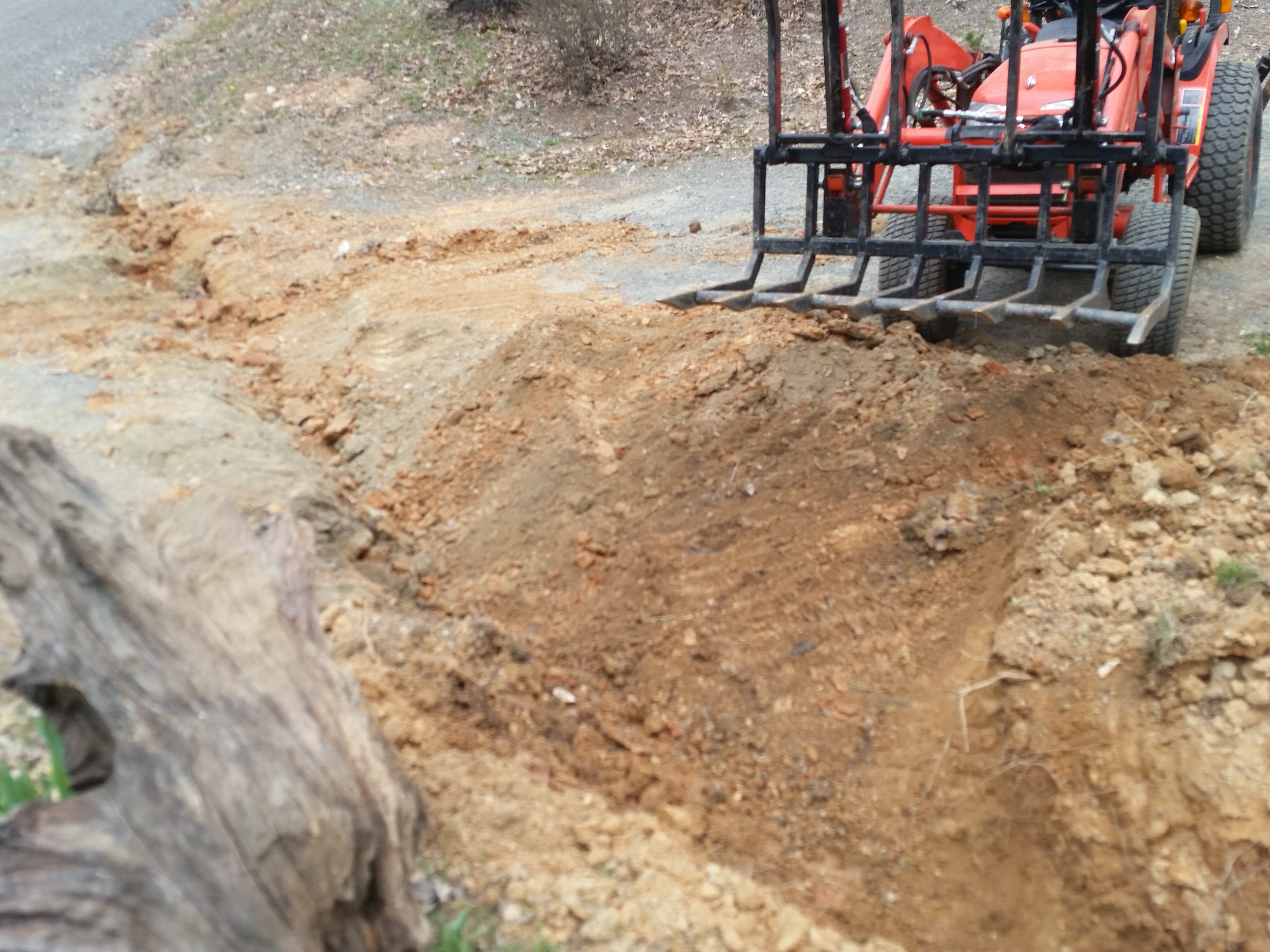

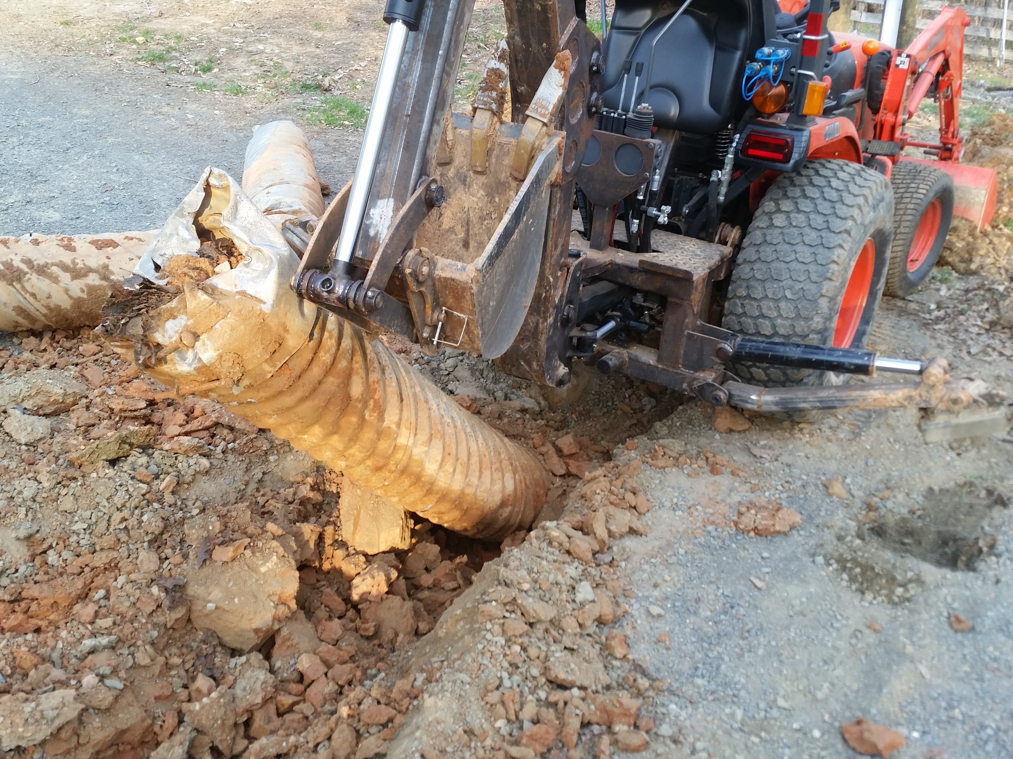

I run turf on my Kubota B2620, looks to be the same size as your tractor. I actually had r4 and switched over about a year ago for doing turf work, like them soo much I don't see switching back.
Fronts were up sized from 23-8.5 12 to 23-9.5 12, mainly because I already had a brand new tire in that size and the used set I bought needed new fronts.
Only pics I could find showing the turfs.

Ok guys. Looking good. TMGT looks like your equipment is earning it's way.

Thanks Mark, it definitely earns it's keep lately.
Your tractor appears to use the same size tires as mine which is lucky because the r4 and turf are available in the same size. For the rear you need a 33 in tall tire.
