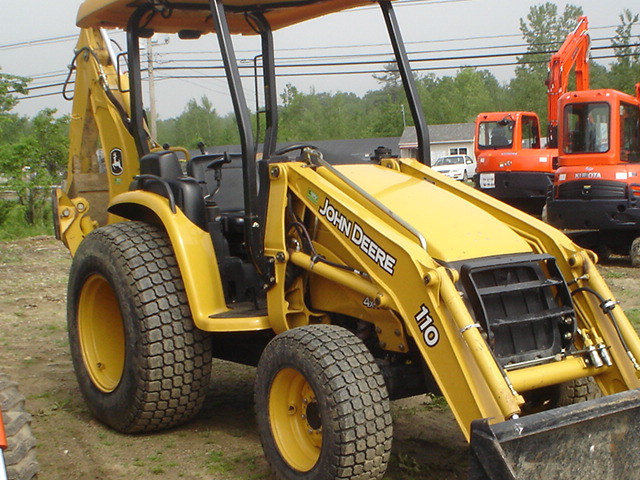

It's not an M59... Not even the right color but I thought it might give you a sense of what the TLB would look like with turfs.

actually, I could see that being a good fit for certain applications. Hoe wouldn't care, only loader work would go a bit. And maybe chains would help that.
