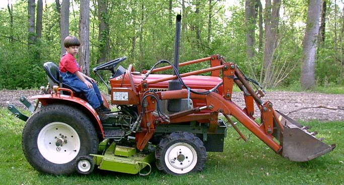

I replaced the 8-16 rice tires on the back of my YM1301D with used 265/75R16 Michelin truck tires. They are almost identical in rolling circumference. I left the 5-12 rice tires on the front because they don't do nearly as much damage to the soft turf as the rear ones did. I have no drivetrain windup even using 4wd on dry pavement (which I don't ever do intentionally).
I attached a photo of my YM1301D with the truck tires, MMM, and loader on (as well as Dad's big helper in the driver's seat).
