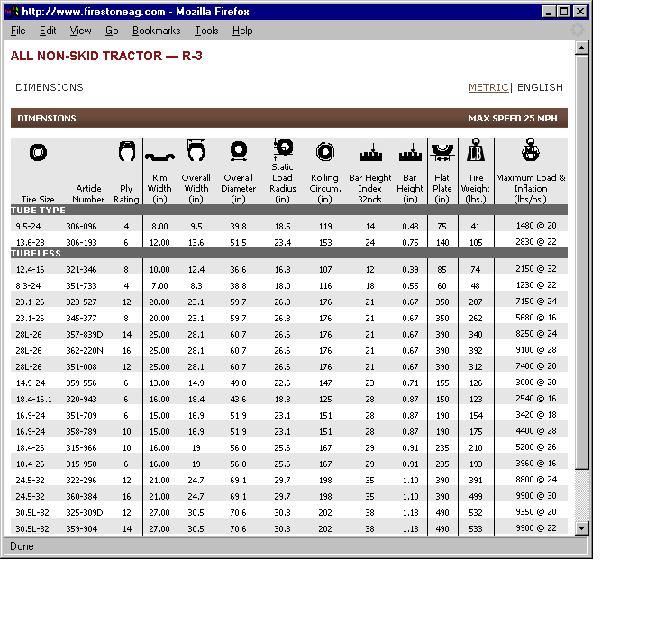

anyone know what size and where I can find turf tires for my yanmar 2000

Not sure if they use the same size tires, but I had turfs on my YM1700. They are Firestone Turf & Field. Size was 9.5-24

Most any diamond tread tire will work that is either 8.3-24 or 9.5-24. Should run $135 each.
