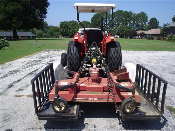

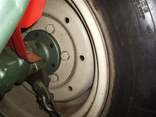

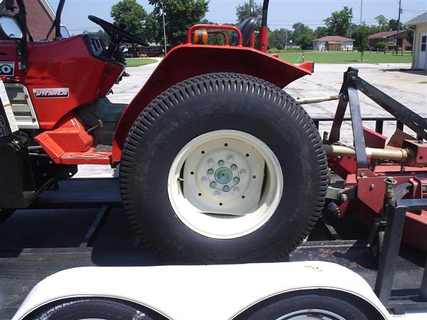

I bought tires and wheels, new pull off, from MF and had adapters made at machine shop for $100. They really made a difference in the tractor. Still have the lug tires and wheels so if I need them it's a quick change.

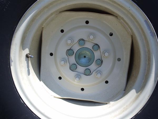

I like your adapter design. A person could almost DIY those. Other adapters I have seen were for wheels with similar bolt hole spacing and ended up pretty complicated because you had to recess bolt heads & tap holes, etc. I had never thought about getting wheels with much bigger bolt pattern & just using flat plate for an adapter. Great idea!

That is neat! Do you have a picture of the back side?

Here you go!!!!
