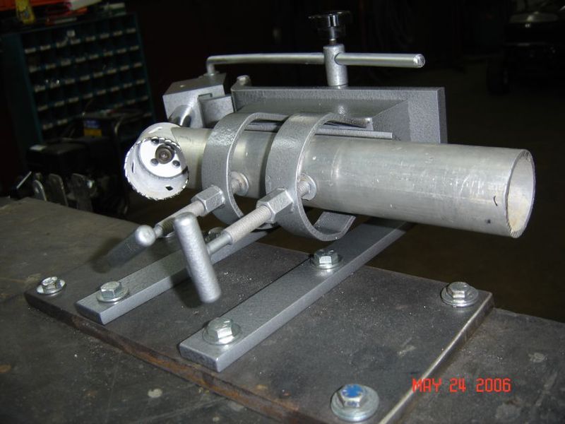

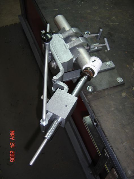

Your a lucky man to have a gal like that! You know your spoiled now don't you :D I wanted one a few years ago becuase I do a little pipe work once in awhile but I ended up making mine. You sure can do good work with them. Here's a few pictures of mine.

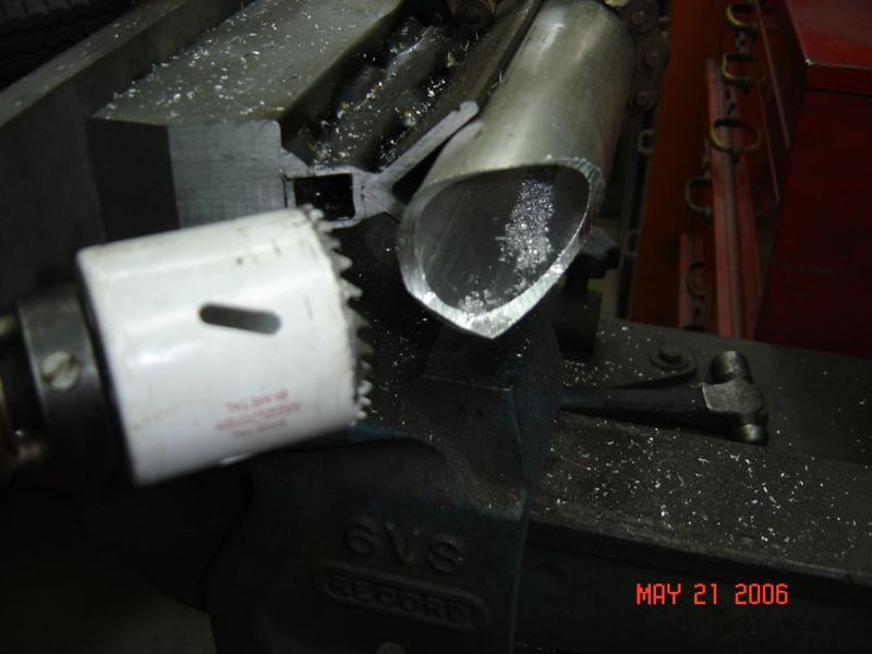

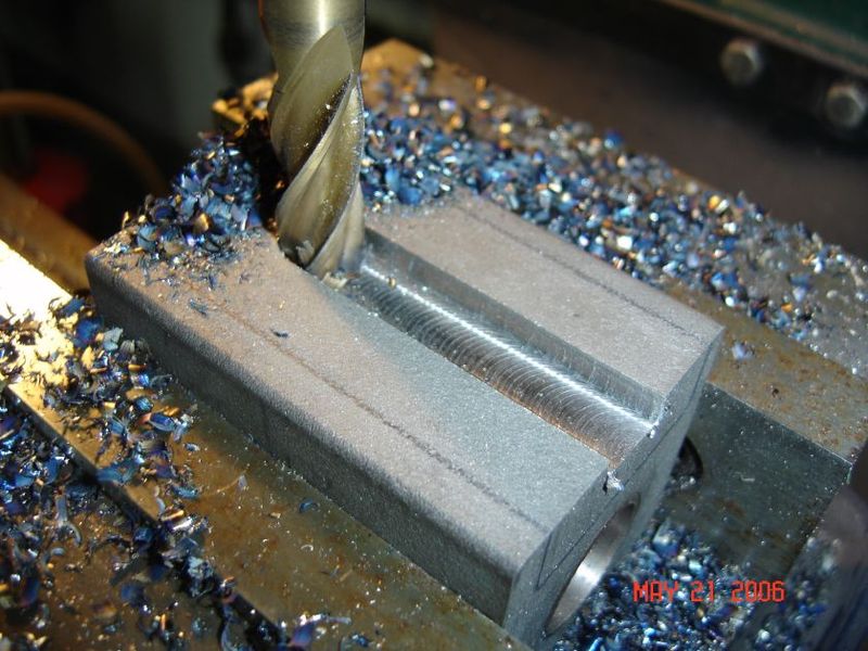

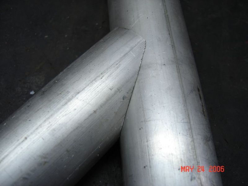

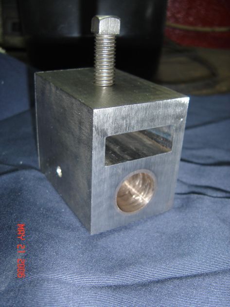

   / Tubing notcher #3
A few more pics :D

   / Tubing notcher #4
Use lots of cutting fluid as you're notching, you won't believe how long the hole saws last. I built my entire rollcage in my rock crawler with one blade.
   / Tubing notcher #5
I do alot of tube notching working on race cars. The best hole saws I have found are Morse. Trick Tools sells them on ebay. They are a fine cut saw(more teeth).

   / Tubing notcher
Thats a great looking notcher ya got there, I had started building mine but My lathe went down I gotta get the 15 hp motor redone. I had the bearing block already Casted and had trouble with it in my Hunk "O"Crap grizzly mill. Thats a good name for it l any thing I do with it looks grizzly lol. I have a big Lehmann Lathe with a 20 inch swing. I mounted the flycutter in it and mounted it to the compund and fed it across. Then my bearing went out in the motor.
