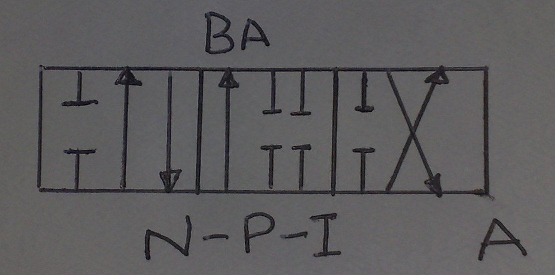

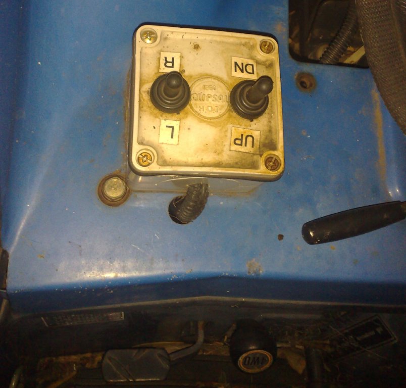

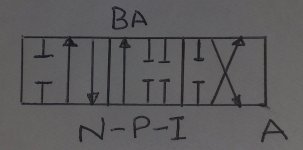

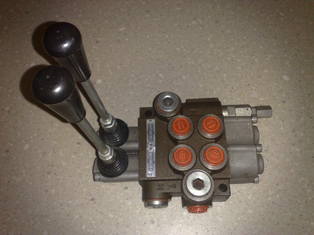

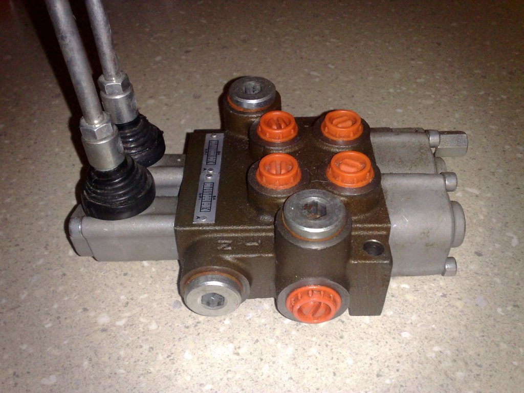

This tractor had the auto-till removed before I got it and a rether unattractive Clipsal box was installed with a couple of centre-off toggles, one for up/down, one for left/right - See the first pic. I bought a pair of "Centre-open spool valves" (or, at least, that is what I was told they were...). They look like the second pic. There is a little porting? diagram rivetted to the top. Couldn't get a good pic of this little shiny label, but it looks like the third pic. Just for good measure, I've included a side view - last pic.
OK - I would like to be able to have some control in the u/d, l/r (Particularly the DOWN when I have something heavy on the back.
How would I plumb these in? Would it be possible to keep the solenoid valves and use these for another couple of attachments?

Originally, when this little thing was living in Rice paddys in China, it had an "Auto till" - this was an electronic device that keeps the tilling tool straight and level, whatever the tractor does. This is an essential bit of kit as rice germinates optimally at a particular depth. This means that the up/down, tilt left/ tilt right are not controlled via spool valves, the electronics fire solenoid valves to do the up/down, left/right.
When the auto till fails, they sell the tractors abroad and that is how I got mine. By fitting a couple of switches, the 3-point is back in service.
I do not want "power-down" - gravity will do fine. When I have the hog hitched up and hit "down", it crashes to the ground at a million miles per hour (ok - not that quick, but it seems like it).
If I can disconnect the electrics from the solenoids, then they can just live there, as long as I can plumb the spool valves in to replace them and be able to feather the controls.
So:
1) What does the third picture (my sketch) show? Does this suggest these are centre-open spool valves? If so, I'm on to something, so I continue to point 2.
2) If the solenoids are disconnected, how do I plumb in the spool valves to take over their function?
What do you think - Is this possible?

The little switches fire the electric valves that are fitted in place if the spool valves. They only do "fully open - fully closed", which is why I wanted to replace them with real spools, so I have more control.
If you trace the wiring (under the seat on mine) you can see where it attached to a pair of "blobs" with wires poking out. These are the solenoid valves. My switches were stuffed, so I replaced them (about $8 each) - they had rotted out inside. To test them, I shorted the centre pin of the switch to the contact each side and the 3-pt would rise, and then to the other side and it would lower. (Don't short to both at once. Might be ok, but might do bad things.) These are the wires to trace. You will need a multimeter to check these.
If there is power at the switch, maybe isolate the wires at the solenoids (Don't cut them if you can avoid it) and try sticking 12v up them (via a fuse, in case you do something wrong) to see if they work.
If so - re-wire the box and hey presto!
If not - Maybe moving to spool valves is the answer, but you might be breaking new ground, as I can't find anyone that has done it before.
