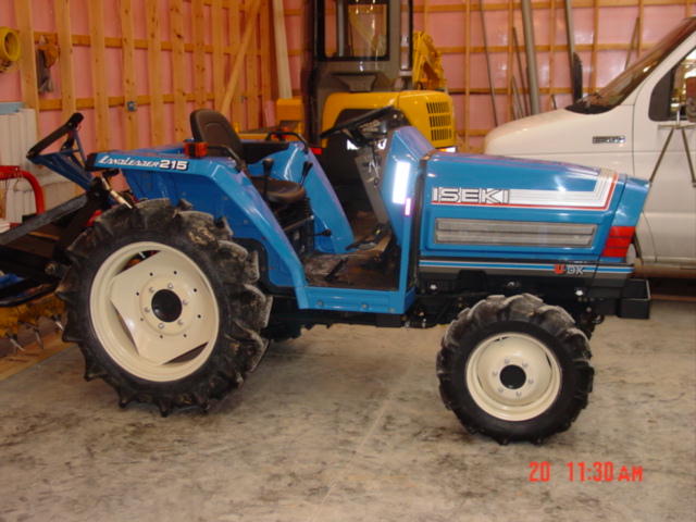

I had a TU240. It was a cool tractor. It was fine for the mowing job I used it for. I now have a TA215. I have attached a picture. It is the best I have had. I wouldn't trade it for any grey I know of.
/ TU 240f #6
Reed,
Nice looking rig, wish I had a few of those on the lot.
Did the TA's go back to a normal cast frame, enclosed power shafts in the tranny housing or do they still have the steel surround frame with detached trans/rear end and the two drive shafts between?
I like the TUXXX nice looking tractor but like Buck said loaders need to be carefully installed and adequately braced for a strong tractor to loader mounting system. Not a lot of places to bolt to.
