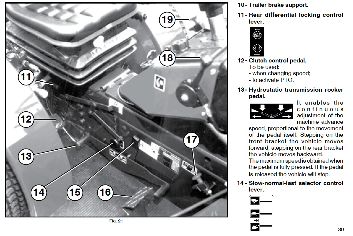

hello, I'm a new owner of a 2007 antonio carraro ttr 4400 hst, this week testing the machine I observed that the tractor don't have the same power and speed when it's move to front compare when I press the pedal to rear. I have a great speed and horse power when vehicle moves backward and poor power and speed when moves forward! testing on a climb, the tractor was struggling, and had no strength to climb, I accelerated but it's like as if the clutch was slipping, testing the same climb move backward, it climb it with no problems... Why this happens? I thought it might be the clutch, but it works well in reverse gear... If someone with experience in hydrostatic transmition can help me?

A question first... it sounds as though the forward and reverse pedal is a single 'rocker' type, yes? (as opposed to individual forward and reverse pedals)
Seeing as your hydraulics work perfectly well in reverse (which means that all of your hydraulics works) the first thing that I would look at is the linkage from the forward 'half' of your pedal to the transmission (or wherever it goes). Something is loose and the movement of the pedal (in that direction) isn't happening.

Hello Wagtail, thank you!
Yes, the pedal it's a rocker type.
I think it's important to say that all the fluids and filters were changed at the official shop. And all the hydraulics works great.
tomorrow I will check for some bad linkage, But seems that I have no access to this, because the axis of the pedal goes directly to the inside of the "box".

This tractor it's reversible, so I think there are no limit, Now I have an idea ! I will try to test this tractor with the reversible mode, so it will invert the hydraulics of the rocker pedal, and I will check if in reversible move it will moves great to forward ( backward in the normal mode) and poorly in backward.
I will try to make a movie tomorrow to show you guys !

I think there are no technique in the pedal, it's just step the pedal, and accelerate in the handle accelerator.
I will try to drive in reversible mode to see if the problem with forward maintain or change, if it's a problem in the linkage of the pedal it will reverse the problem, right?
