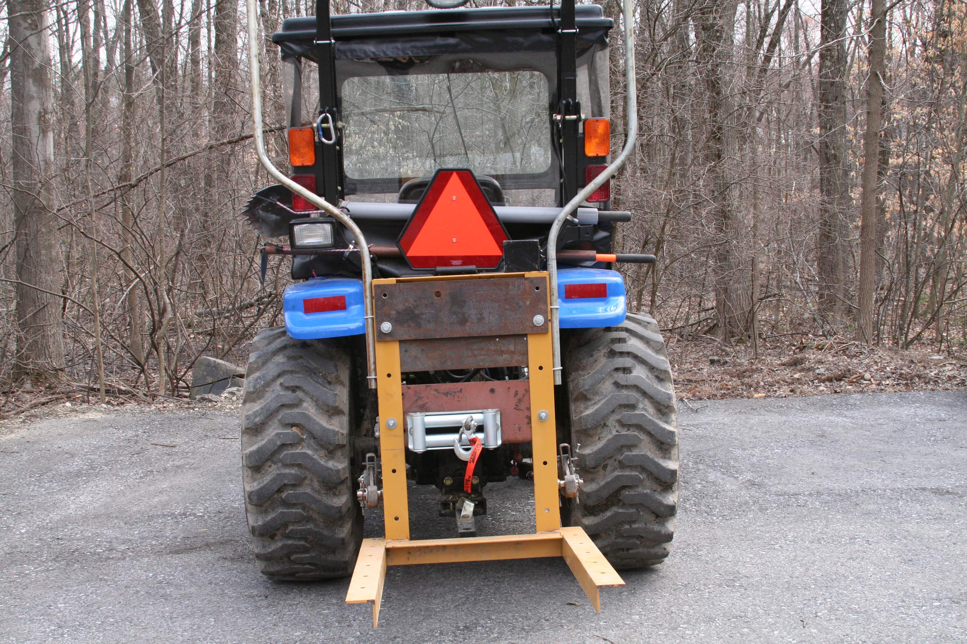

Got a good price on the TSC Carry All, it looked to be the older more heavy type. Built 2 1/2 x 2 1/2 x 1/4. It had a little rust on it, so I was able to get the manager lady to knock off another 10%... Anyway, I wanted to build my own Carry All, but I couldn't beat the TSC price, my steel guy gives me good prices, but 2 1/2 angle is not cheap... So I just bought it.
I got to thinking that I could build a nice little bed for the back of my tractor to bring wood in on, I normally put my loader forks on and then get a pallet, but I think that this will hold more (when it's finished) and I could also put wood on the front. I figure that the more work I can get done in less time is better...
So, I broke out the old buzz box and got to messing... I hope to finish the deck this weekend, I'm just going to slap on 3/4 plywood. If the weather gets a little warmer I'd like to get some paint on it too... I have it attached to the Carry All with grade 8 bolts and nuts, I'm pretty sure it should hold up okay... I also did it that way since I would remove it from time to time... Enjoy the picctures, even though they kind of suck, it was with my cell phone... I'll have to get better ones. :eek:

Nice work. It looks a little big though:D
What are the dimensions??? It appears roughly 5'x6'
If you stack wood on that 2' high, that would be 60 cu ft. 60/128=.46 cord.
That would weigh between 1500 and 2000lbs and a good ways behind the hitch. You may not be able to fill it full. But I still like it.

Good eye my friend, the dimension are almost 5 wide by 6 long... I figure I'll stack most of the wood toward the front, and then less toward the back, but I should still get a LOT more on it then my old setup of loader forks and a pallet... That setup was putting too much weight on the front axle, to the point where I almost could not steer...

Deffinatally a nice build. With most of the weight toward the front and not stacked you hould be fine, as long as you ahve the loader on. If you take the loader off, and load that up, you may need to steer with the brakes as your front wheels might be airborn:D

What if you used Pin's insted of bolts on the wood floor'ed rack.. and put some extra legs up front..then you could set it down and slide the 3PH attachment out and it could be a Wood Hauler AND wood Stand all in one!

I was actually thinking about that, making the bottom longer so that it would slide over the carry all better, but that darn 3 x 2 1/2 x 1/4 is expensive... I'm going to try and get some paint at TSC later today and get it painted then run to Home Depot and get some more 3/4 ply wood... I can't wait to test it out! Thanks for the ideas CowwFace!

Yikes I thought I was looking at my tractor.

HaHa, nice choice! I love my TC34DA, perfect "do-all" size! I like your setup, is that a winch? Good idea... I was thinking about adding a spot for mine, but right now it's bolted to my truck... It's pretty easy to add stuff to these carry all's, gotta like that!
