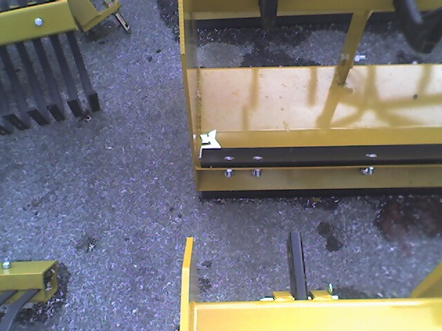

Saw Dark Horse 5' and 6' here in Winchester, VA, $300/$350. Salesman said when TSC returned all their Minot tractors to China, they wouldn't give their money back, but gave them Dark Horse boxblades/tillers/etc. instead. Considers them pretty much junk.
They looked like they would be OK for light duty stuff, scarifiers seem exact the same as KKII box blades and the box frame they are mounted in seems strong, but the sides are pretty thin.
Interesting, if this picture is clear at all, is that I saw two KK box blades right next to each other and I assume same price, but the steel on one was noticably thicker than the other.

One of the major concerns for a box blade is weight. The 3 pt has no down pressure. So if the box blade does not have enough weight it cannot get a sufficent amount of dirt, it will just drag over the top of the soil. Thin steel means less weight. I would also be wary of the quality of the steel.

.....Interesting, if this picture is clear at all, is that I saw two KK box blades right next to each other and I assume same price, but the steel on one was noticably thicker than the other.
Mike
Interesting, saw the same thing here in central Texas (San Marcos TSC) identical KK BB-60s; 3 of them with 1/4" plate end caps, spotty welds, and one BB-60 with 5/16" plate ends and a noticably better quality of welding and fit. Bought the good one. All the same model, price. Maybe it was the last made in America unit.
They also had one Dark Horse KK knock off. $200 less. It seemed to be the same materials and construction as the "lesser" KKs. Interestingly, while the KK gear arrives unpalleted and is generally beat-to-dirt by F-lifts and careless employees, the DH BB was "crated" with lightweight 1" angle iron tack-welded together. That doesn't speak well of their own experiences moving them.
