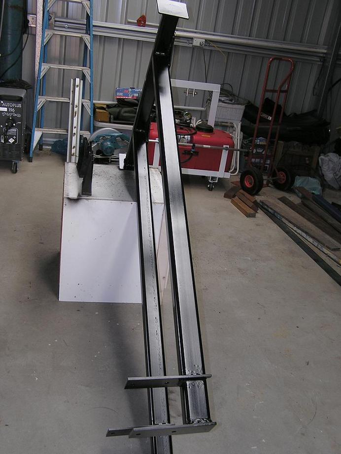

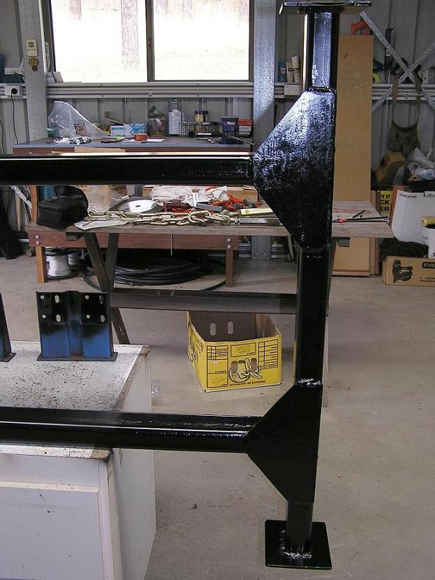

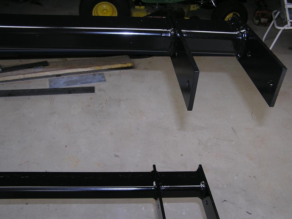

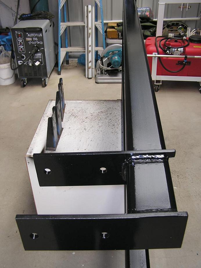

Rich/Dave
Thanks for your input, look like we have to do our own thing for ROPS. I have looked at several different larger makes/model to get a feel for the size of material etc required. I feel pretty confident that I can "over engineer" something suitable to make me feel safer.
