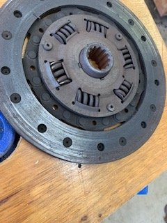

I am just starting on a Clutch repair journey. The clutch just stop having any resistance in the pedal.
I have the part manual with drawing but that is it. I don't know a source for any parts i may need or the instructions on the step by step replacement procedure.
Any help you can give me would be very much appreciated.

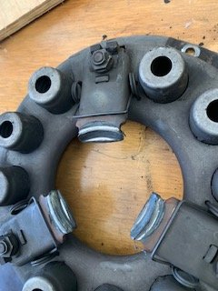

Pressure Plate Levers shot also Clutch Release Bearing & Clutch Disk.
This maybe the end of the tractor if the parts are over $1,000

   / TS 1610F 4WD Clutch Repair #4
they shouldn't cost that much, but I don't know about Iseki.
   / TS 1610F 4WD Clutch Repair #5
I believe I sent you an email with pricing for under $1000. If you do decide to sell the tractor as is, I'm always interested in parts tractors.
