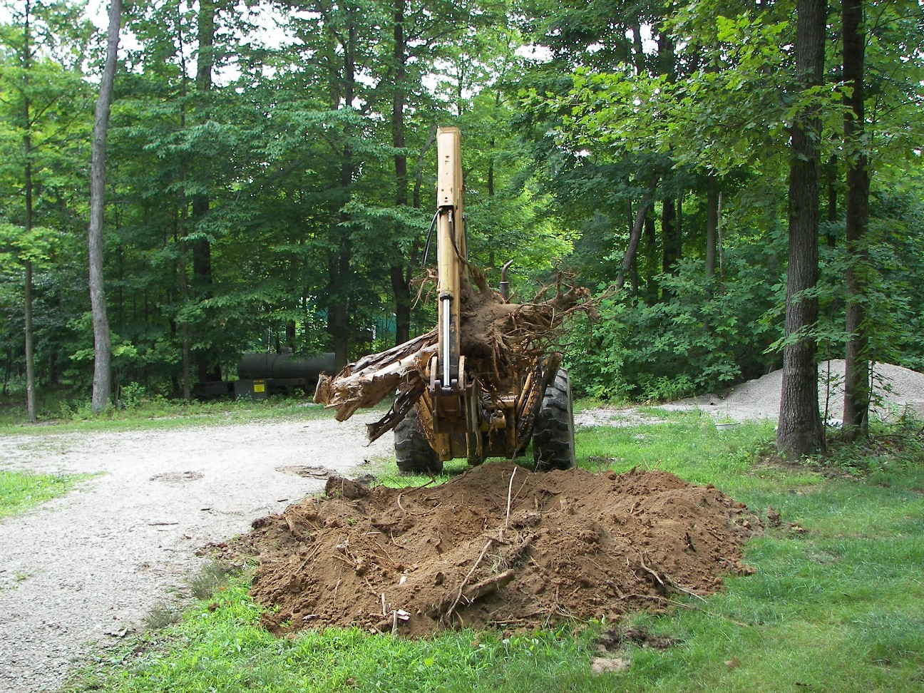

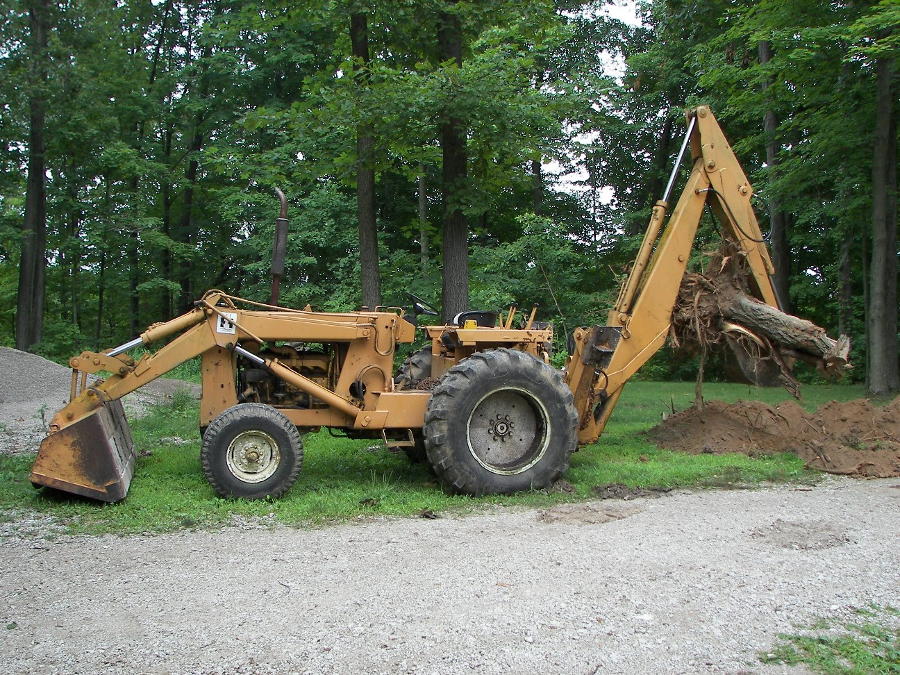

When I was trying to decide what to purchase when I bought my property and build I decided to go with a full size TLB (IH3616). I also needed to put a perimeter drain around my old house as well. My new property needed a 1200-1400 ft driveway that went up about 100' in elevation in the first 800'. Even though I had the full size TLB I hired an excavater that had a lot of experience in dealing with driveways and inclines (drainage). They brought out a dozer (Cat D6 I believe, big!) and a TLB and made a much nicer driveway than I ever could have. They partially moved a hillside and partially filled a ravene. They took care of putting in 2 catch basins as well as several drainage tiles. I paid about $7500 for the whole project. I believe the labor portion was about $3000 I know there was around 300 tons of gravel brought in. I am glad I had them do it, the driveway holds up very well and doesn't wash out bad. Having the full size TLB was still the most usefull tool I had while building. The power and reach was great. Shortly after moving in I got a smaller Kubota(B7200) to do the grading and finish work. Having the 2 tractors, one big and one small worked very well and I only had about $12-$13,000 in both of them. Actually I got a complete full size TLB for what just a BH attachment would cost on a compact utility tractor. Even now with my B2620, I have still got the big IH TLB out to take out stumps that were just taking too long with the smaller tractor. Another big plus was I didn't have to be as worried about the old IH TLB sitting at the property before we built, since I didn't have that much in it. I still consider keeping the IH, but it was part of my justification for the new B2620 to get sell both my old tractors and replace them with 1 new one, now that most of the big work is done around my place. Which is part of the reason for the B2620 with BH, because my IH leaves ruts and tears up the finished yard too much and I am afraid of crushing the finger system. The 2620 is better suited for landscaping and maintaining. As mentioned Even 12" - 14" stumps can be a problem to get out(see pics).
If I had to pick just 1 tractor to do heavy work but not too big I would go for something like the L4400. I don't know what older models this would be equivelant to. It is not much bigger than your old 3010 and is quite a bit more tractor.
