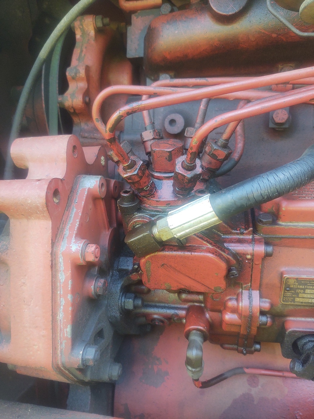

Put new fuel filters on tractor....but, concurrent with that, engine died (died first and then went to change filters before firing back up)
Long story short, don't seem to get any fuel at the injector so my question is, if I take fuel lines off at this round head.... wouldn't I expect to get a STRONG pulse of fuel out of here? (much easier to reach here than up to injectors)
In case I still have air in there.... (bled fuel using the valve above the second filter), is there a port on the pump itself where I can bleed the pump or is that done at the filter where I bled it there?
I'm about ready to yank pump off to take to show just to rule it in/out.....except it's an hour drive to the shop and with work, that causes other issues.

There is no bleed screw on the pump..
The line going into the pump in your picture is the main inlet..
The hand primer on the back of the pump is usually all u need..
Unscrew the “thumb screw” flip the bracket out of the way and start pumping..
Any air in the line will travel out of the pump..
Hope that helps..

Sorry, I just looked at your pic and I see it's a 6 cylinder. thepumpguysc is correct and I was wrong. some injector pumps have an injector primer on the pump that you can bleed the air out of. My tractor doesn't have that setup. Some systems are harder to bleed than others usually the more cylinders the harder they are to bleed.
   / Trying to diagnose / bleed fuel pump
was a bad pump. replaced it, was 360 out of phase, rotated shaft and (essentially) fired right up. stripped bleeder valve, new one arrived yesterday, going to try to replace today or tomorrow
