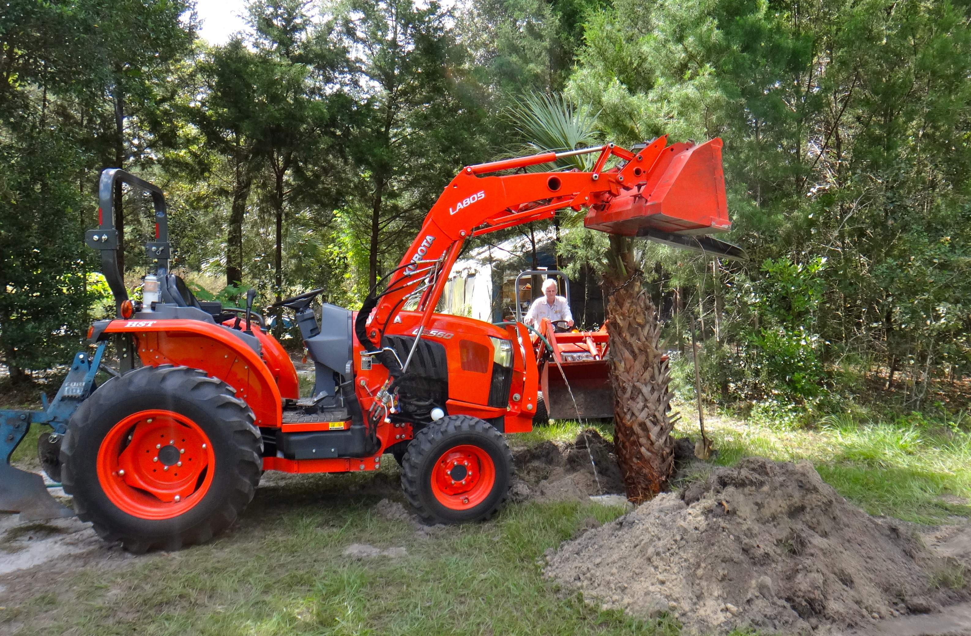

I have had my L3560 since January 2013. Great tractor; trouble free.
The HST PLUS transmission is superb.
Ordered the more powerful LA805 Loader and L2296 Heavy Duty, Round Back Bucket, which has SSQA.
The L2296 HD, RB Bucket makes a rigid mount for a Bucket Spade, which is really useful.
To fully utilize the lifting potential of the optional LA805 loader you need about 600 pounds of counterbalance mounted on the Three Point Hitch if your tires are filled only with air, as mine are. I usually keep a Cultipacker mounted as counterbalance, as I roll trails frequently. Sometimes I mount my Rollover Box Blade as counterbalance.
This is my second new Kubota. My first new Kubota was a B3300SU tractor-loader package, very similar to your L3200. The L3560 will impress you.
