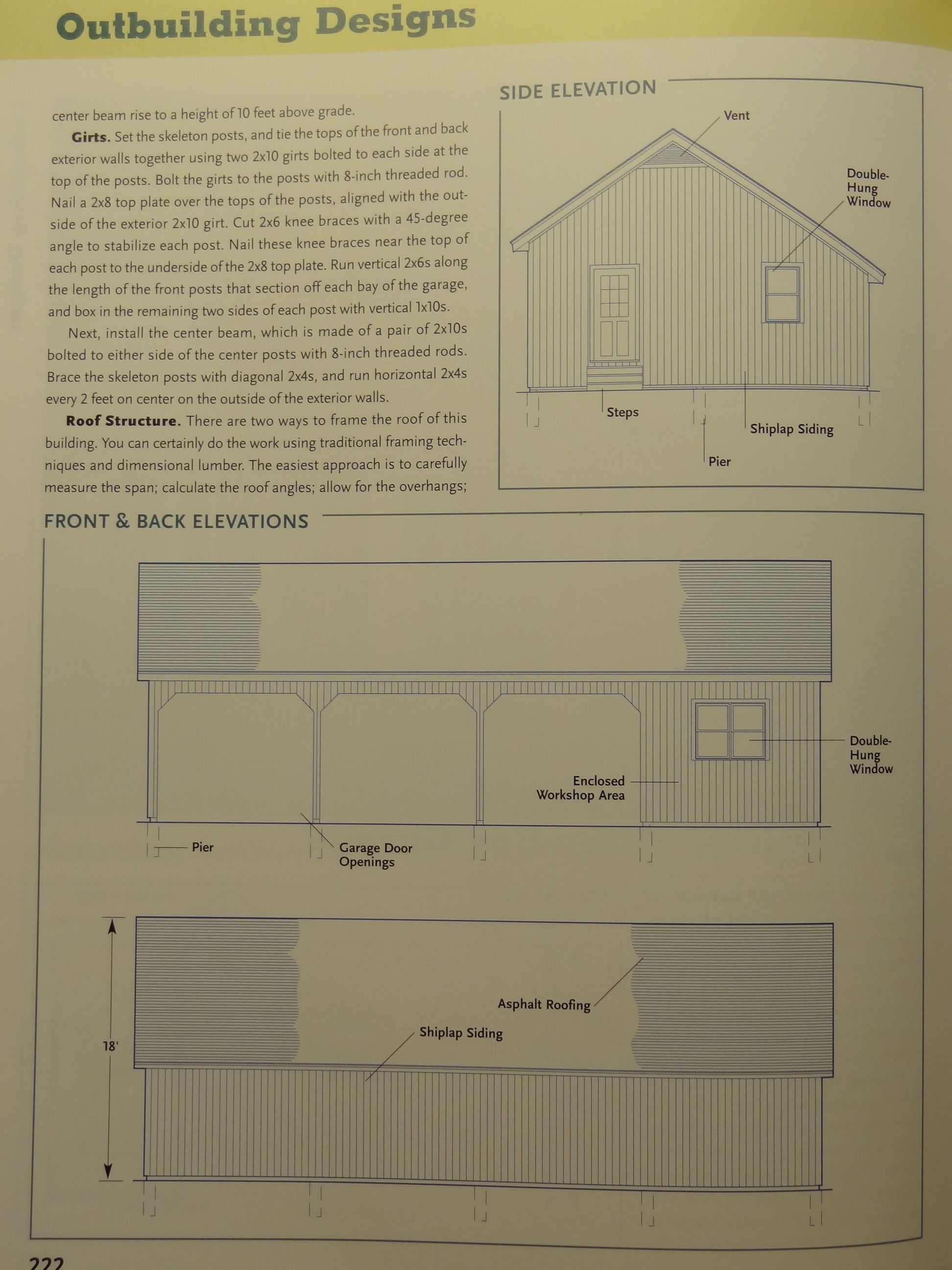

I am building a barn that is 24' deep and 36' wide with four stalls (2ea 10' wide and 2ea 8' wide) with 10' high openings. The openings will run along the long side as if it were a run in shed but the roof will be standard gable with the peak running the 36' length. From the front (north) corner to the far rear (south) corner the land drops about 30"? This is the best spot other than where the house is built and I think my wife would be upset if I wanted to relocate the house. I was going to use 4x6x16 posts on the outside walls and one roughly center (adjusted to not block the stall location) for additional roof support. These will be planted about 24" (bottom 3ft wrapped in tar paper) with gravel in the bottom of the hole and dry concrete poured around the post with the last 6 filled with dirt. The spring rain is here so the concrete should set fine. I want 10' high openings so I will make the opening 11' or 12' from the ground so I can add gravel at the end for a raised floor. Once I have the wall posts in place I will find my floor level and from that level I will then place treated 2x below the line in the dirt to about 4" and work the slope until I am down to the concrete of the far corner post. Place some perforated drain pipe (have left over pieces) along the back wall and run it out the lower end. Fill with dirt just short of the level board and top with 6" to 12" of gravel. The gable rafters will be about 24" apart (probably over kill but if I have to climb up there I really want it to hold my big b). The roof will probably be corrugated metal roof and I have not decided about the walls. Using a framing nail gun for the initial build but will go back and add bolts and screws at the end. It seems like an odd size but it will hold all of my stuff plus room for my sons to work on old cars. One of the 8' stalls will be enclosed for storage of the tiller, chains, small gear and no door on the other stalls. 4x6x16 posts are a pain to locate so I might build my own with 2x. Suggestions?

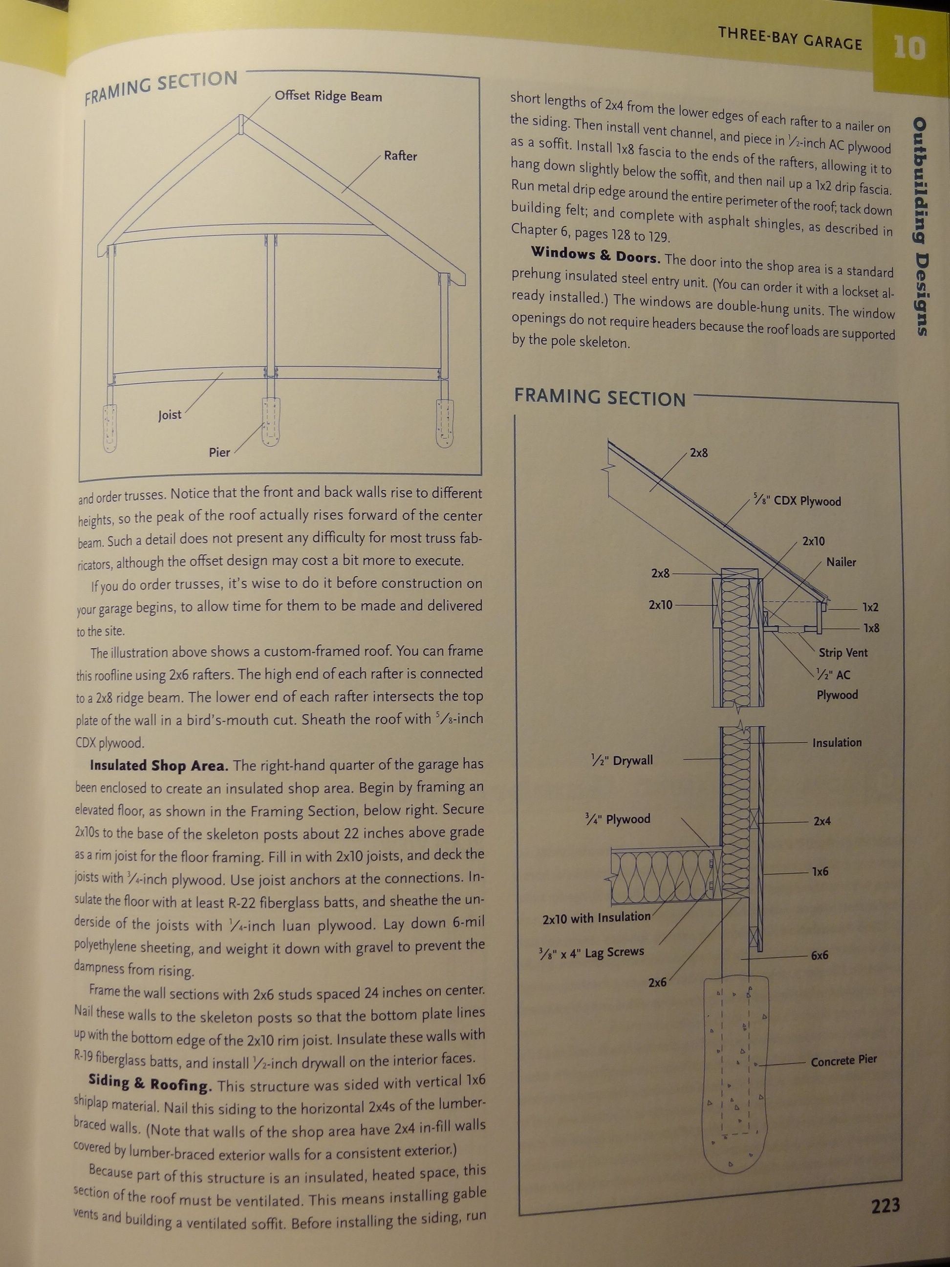

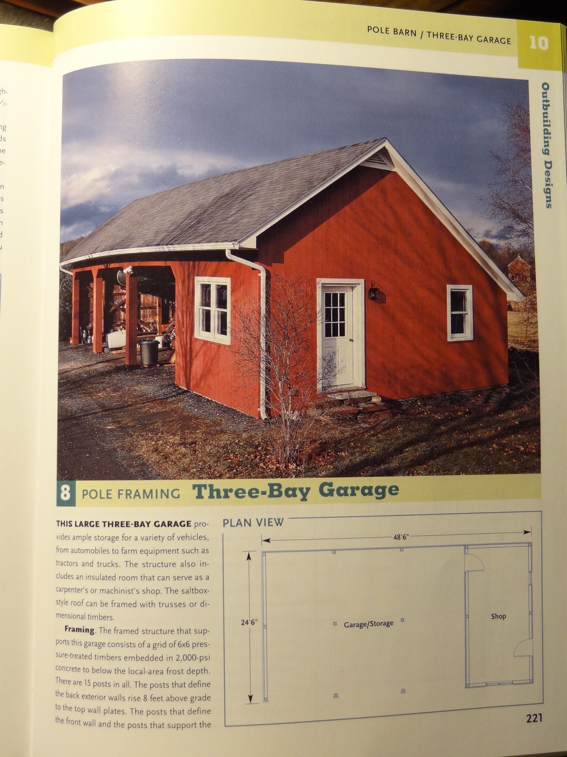

Maybe you're interested in something like this. (See attached pics) I just found this while looking through some of my books from when I was planning our barn last year.
