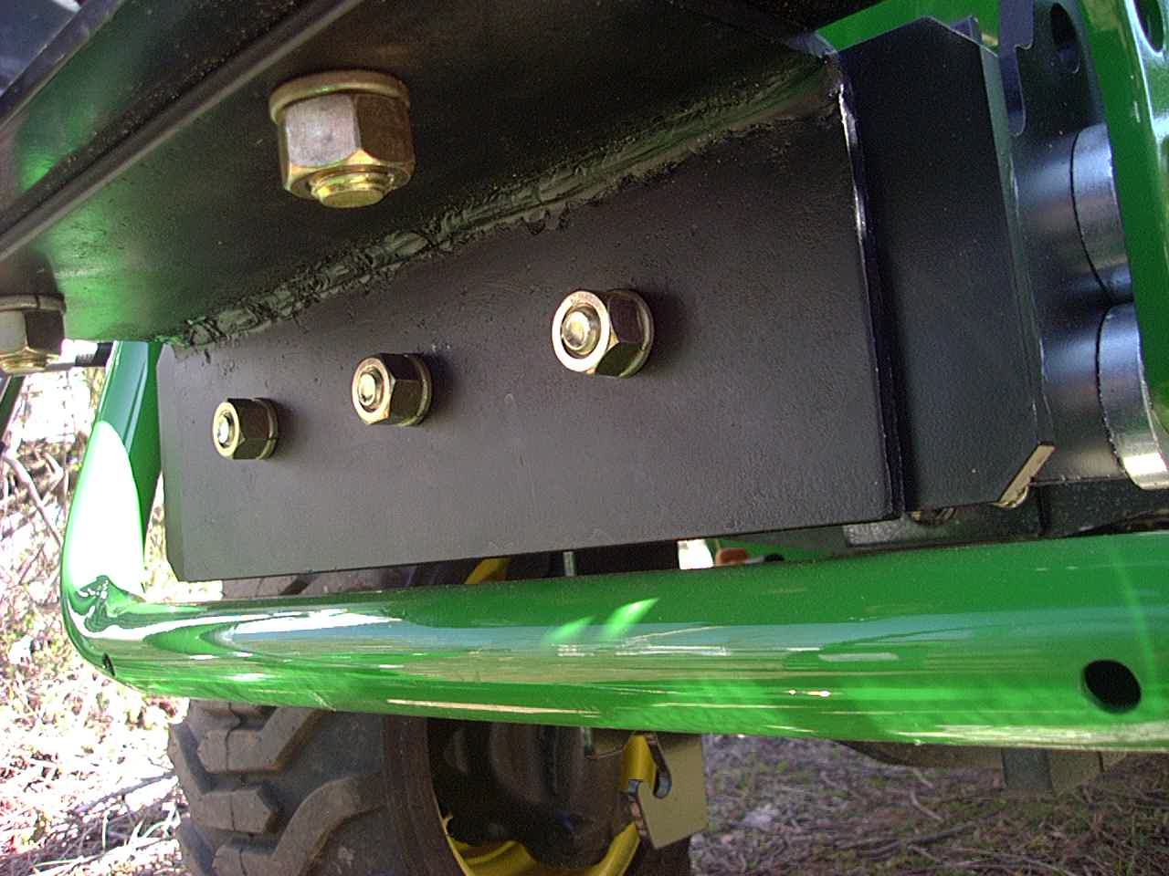

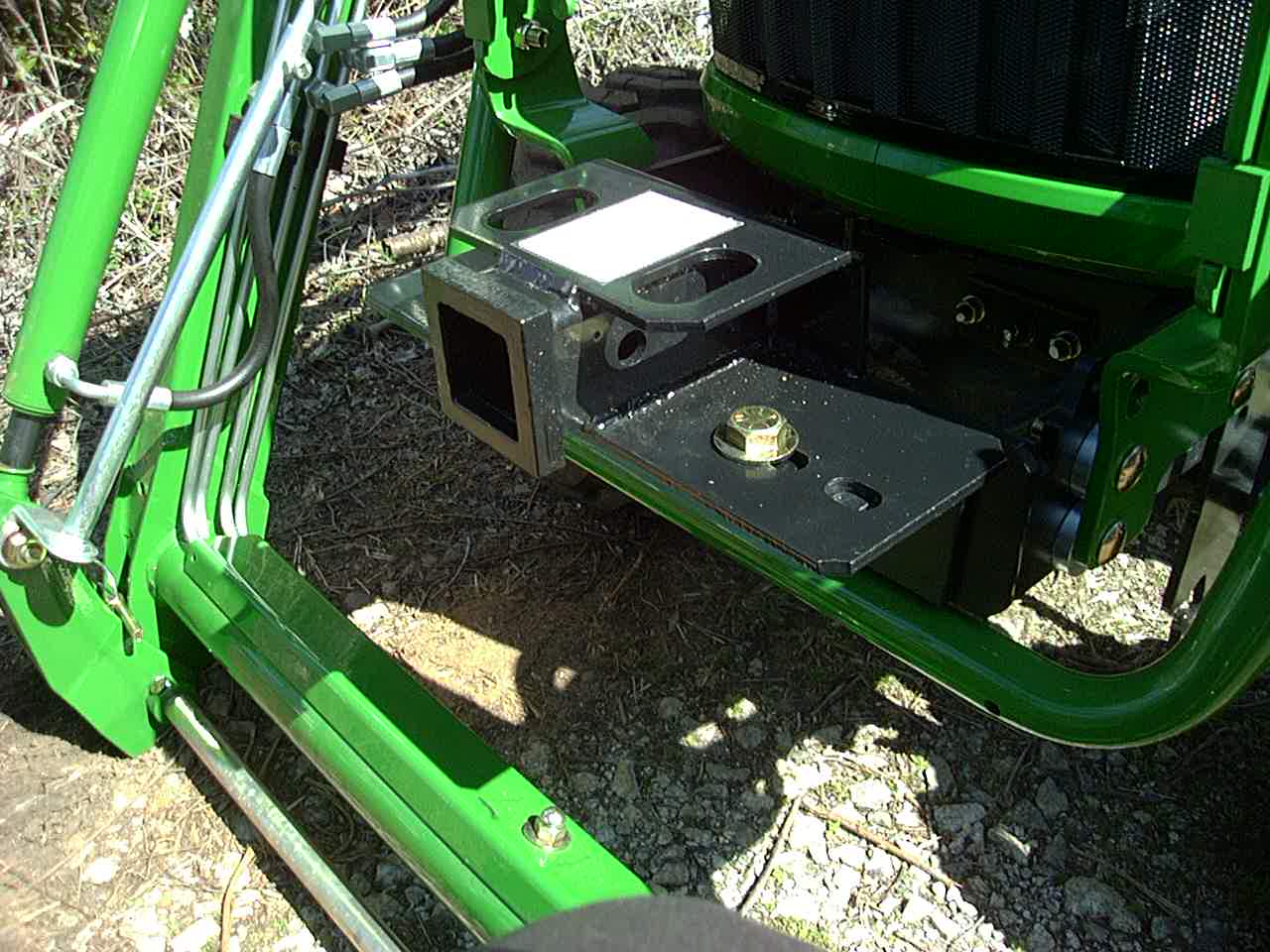

Especially if you are elderly and have restricted neck motion.
For my 2305 I got a 12" 1/4" 4" x 4" angle iron and a receiver adapter from harbor freight called step bumper receiver 97019-1VGA @ 19.99.
Bolt the angle iron up or down on the front quicktach bar and the step bumper
receiver on top or bottom depending it you want the receiver low or high,
Sure can push a trailer into a tight spot much easier than backing it in behind the tractor.
This attachment does not interfere with the 200cx loader

I put trailer balls on the front bumpers of some of my tractors.. makes good trailer 'tenders' when needed..

Willl, you come up with some of the neatest stuff. Is that a dedicated hitch or have you made other attachments to fit it, like a shovel or boom pole perhaps?

Gee Willl, just where have I seen that JD Quik Tach bracket before? Let me think.........Let me think.........:) Scotty
