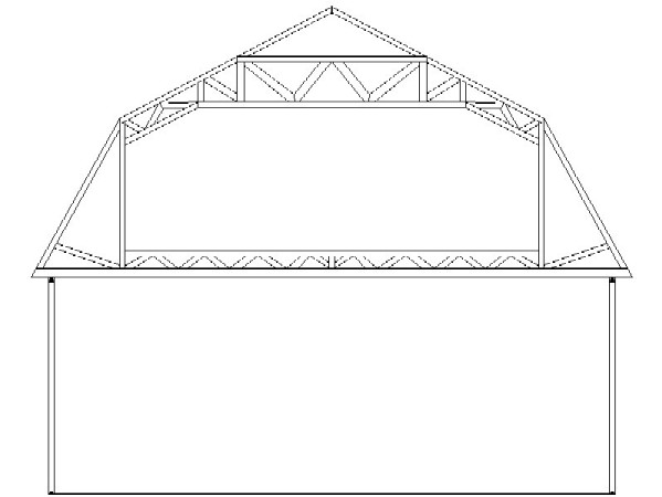

Considering that I'm having this complex gambrel attic truss design for a 32' wide barn built and delivered to my site for about $300 each, and will have a complete clearspan floor system in place with them (except for the actual T&G plywood flooring), the $264 per pair does sound expensive. On the other hand, my barn will be stick built, which means I need 25 of the trusses for a 48' barn, so my total cost will be about $7500. They're engineered for 120 MPH wind load, required here in Florida.
The attached drawing is accurate as far as the main chords of the truss. The truss company won't release the official drawing of the complete truss with webbing to me until I place my order (with a deposit), so the webbing in this drawing is not accurate, and is based on about a 30 second look at the "real" drawing. But, it's close enough to tell the story.
Of course, I also lose some storage space on either side of the vertical chords, but the height is 6'2" above the loft floor at the edges and 8' across the center. The clear storage space is 23'+. The top peak of each truss will be delivered separately and will have to be assembled at the job site. Known as a "piggyback" truss, this is because the trusses are too tall for transportation.

Looking at the drawing you can tell that truss is designed to take a large wind load and loft storage load. I would guess you would never get that kind of strength out of the other system, not even close. I think you are infinitely better off getting those engineered trusses. That 120 MPH wnid rating is a killer. Those trusses don't seem like too bad a deal at $300.
