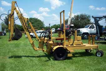

It might do fairly well on you property in your type of soil. It wouldn't in mine. I think that a truckhoe would have the same disadvantages as a CadPlan hoe. I don't see how you could use all of the power without a mounted unit through the entire movement of the machine. When you use a hoe on a tractor even with the tractor and loader to anchor it, it will be moved around some. I wouldn't be happy with the mobility of it either. Not only would it be difficult to maneuver on site, but you couldn't cross ditches if you need to. I have had two different hoes on two different tractors and I wouldn't trade them for a truckhoe. But like I said it might work OK at your place.

Good points. Let me think out loud. In my case, I'm not concerned about the stability compared to a unit mounted on my tractor, because at 4700#, the truckhoe is twice as heavy as my tractor would be even with a backhoe mounted. Attached is a picture of the actual unit that is for sale - as you can see, it's probably even bigger than my tractor.
As you mentioned, I'm concerned with the mobility, too. However, I could keep it hooked up to the tractor and move it that way when I need to, as a trailer. It's no less convenient than jumping off a backhoe seat and onto a tractor seat on a "regular" tractor-mounted backhoe. The good part is that I can unhook and leave the backhoe in place if I need the tractor for something else.
Crossing a ditch is something I hadn't thought of. Maybe a good set of heavy planks can do the job.
Thanks - you've given me some food for thought.

Some of the utility companies in this area are using the towable backhoes. dig-it One of my buddies acquired one, which I have used for digging and trenching and it works well in our red clay. Have not tried it on any tree or stump jobs. Yes, you can cross trenches with them. All of the movement is in the hoe circuits so it does take some getting used to. Working along a trench is ok. Moving from point a to b can take time because you are crawling the machine, but in MO it is not any more time than some of the mini-excavators because they crawl slow also. We rented a Kobelco mini for a job and ground speed was not it's thing. See if the guy will loan or rent you the towable unit for a weekend and try it out. Like everything else, resale is???
