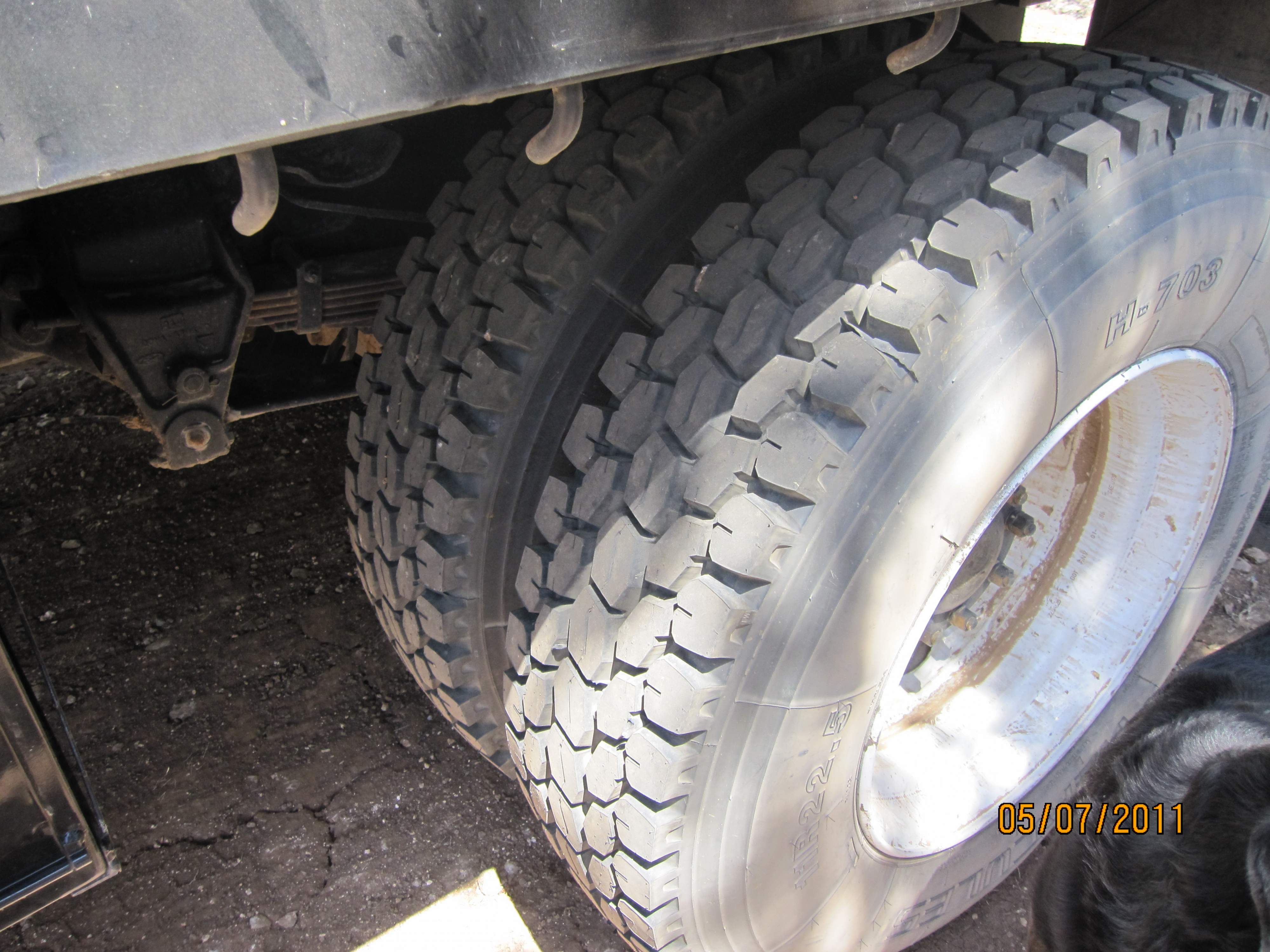

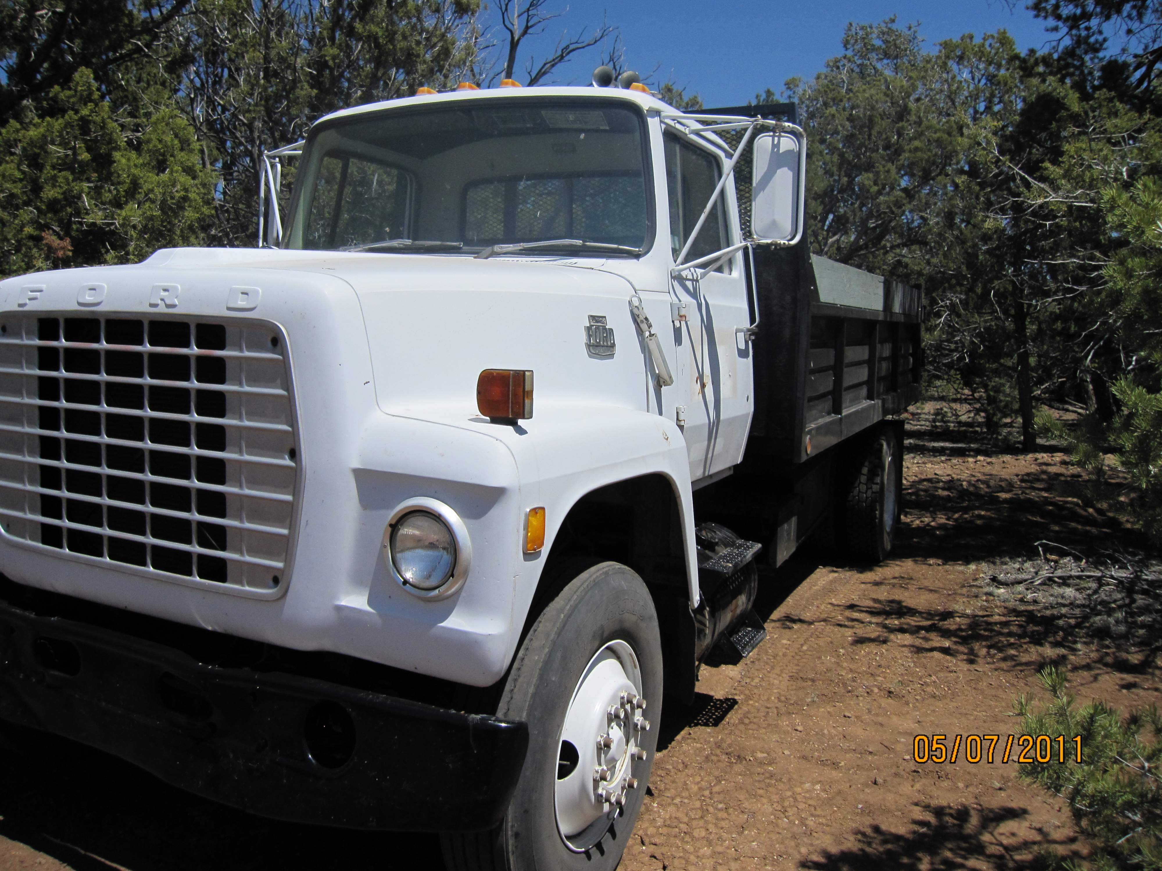

I just decided to go for it and get all four for the back. Since 90% of my driving will ne off pavement, I got something with a little meat in the tread. How do these look for driving through mud or snow? :)
