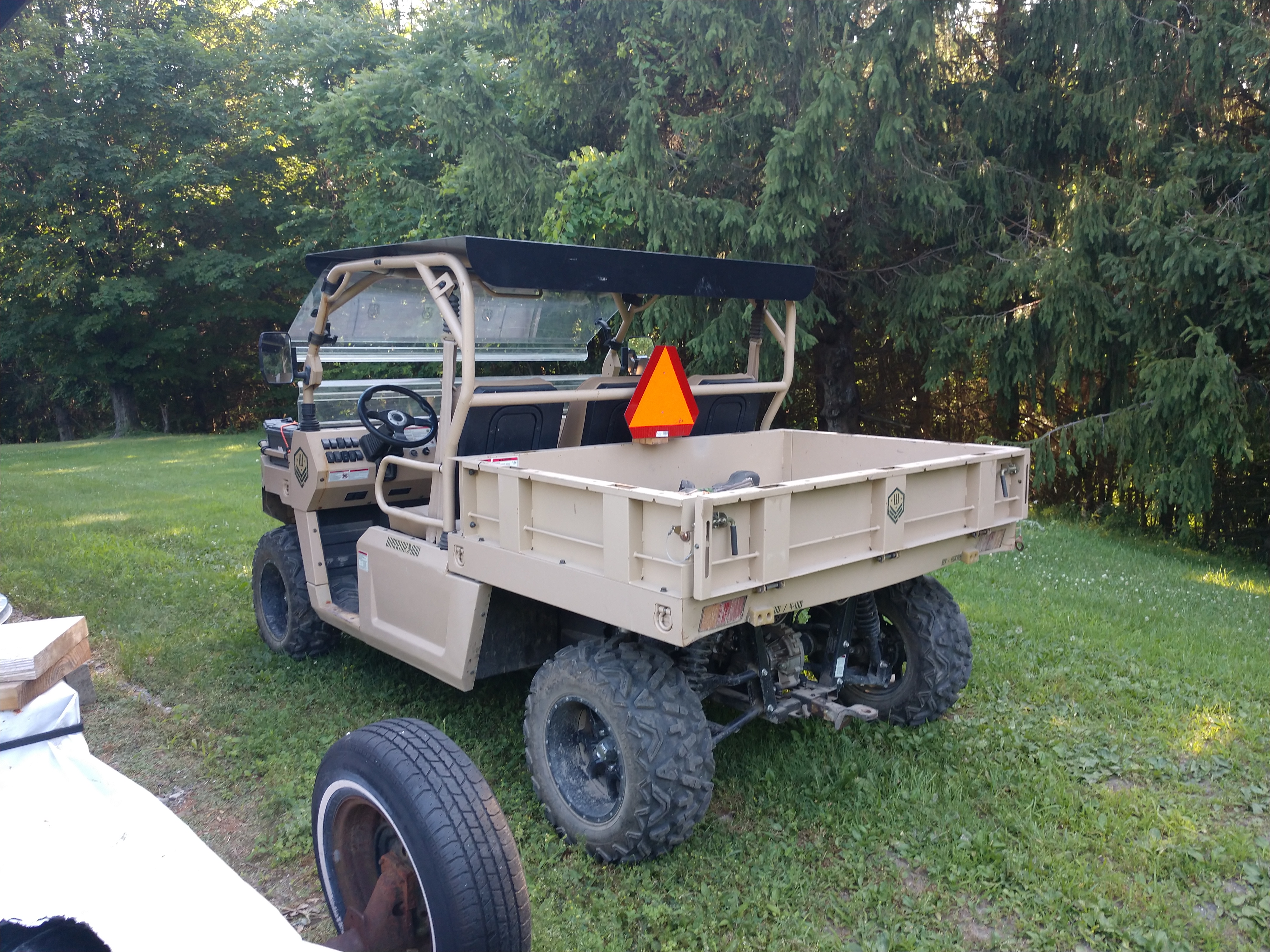

My utv has DOT rated 6 ply tires on it, 27x9-14 Fronts and 27x11-27 rears at 12 pounds of pressure they do good on roads as well as fields.
   / Truck tires on a UTV? #8
So does my wife's. Not the usual bar tread rough riding tires either. We (she) takes it up town all the time, you can ride on the road here as well so long as you have the proper tires, a rearview mirror, turn signals, horn and hazard flashers...and a valid drivers license too. Makes a great go for gas for the lawnmower vehicle. I say my wife's because I rarely get to use it.

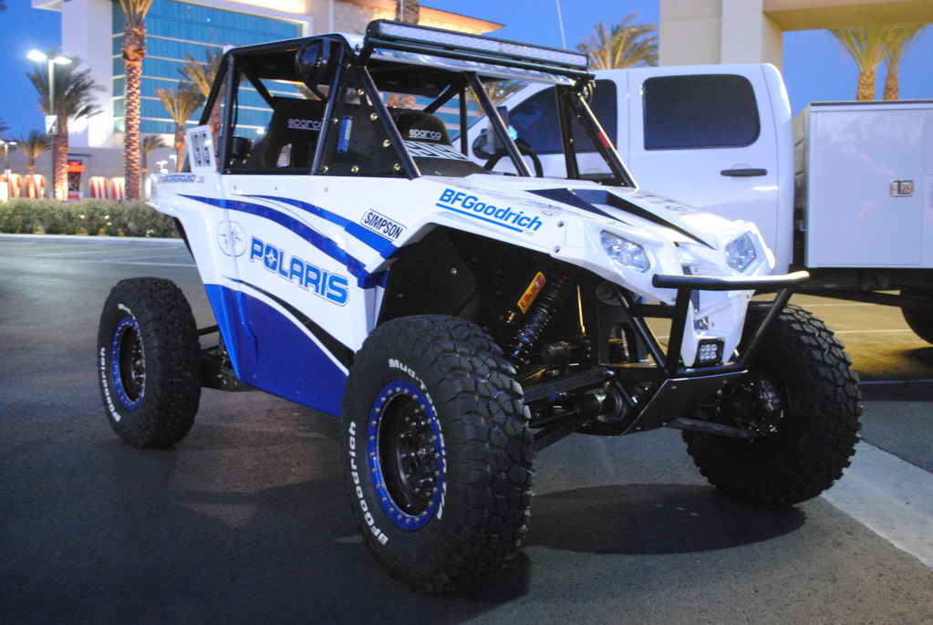

I have seen plenty of UTVs with BFG mud or all terrain tires mounted
