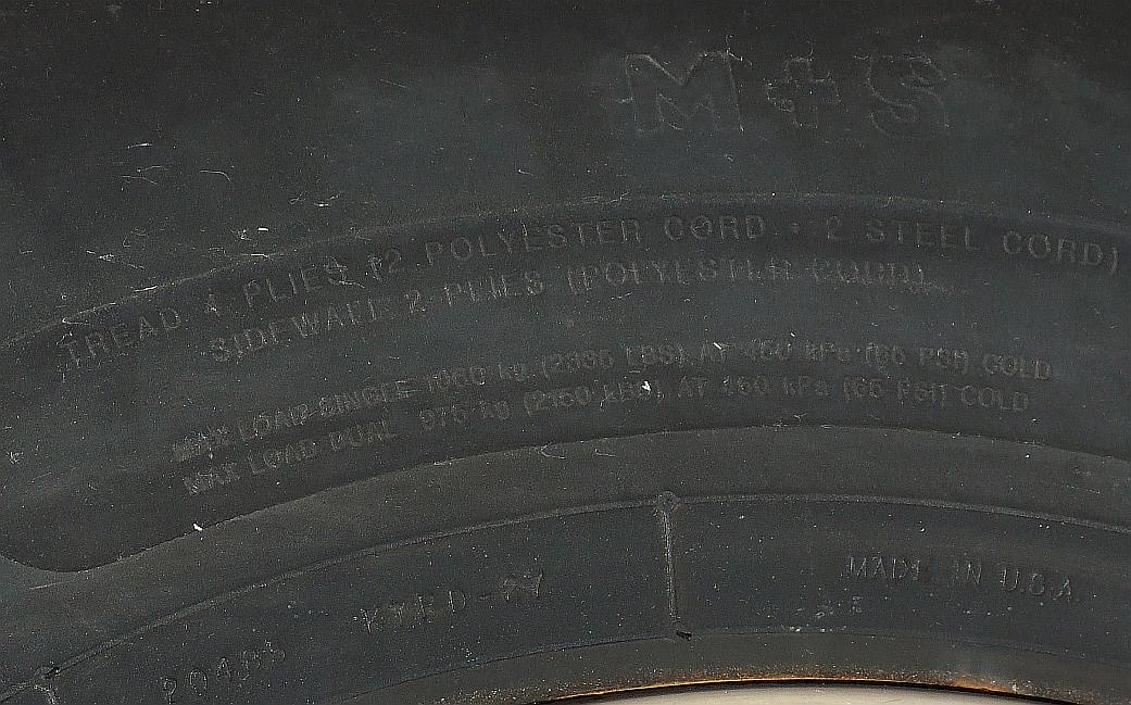

I'm going to ask what should be an obvious question...do I go by the tire pressure rating inside the door panel of my truck, or do I go by the rating on the tire itself? The door rating says 32 front/35 rear, the tires say 44lbs max cold. Since that's a difference of nearly 10lbs I'm kind of curious as to what number should be used, mostly for fuel savings and to prevent premature wear on the tires. I bought the truck used so I'm not sure if the tires are factory or not (they appear fairly new and the truck has less than 20k miles on it).
I try not to ask dumb questions but since this truck is not very kind on the wallet at the gas pump, I want to squeeze as much mpg out of it as I can, but I don't want to over or under inflate the tires.

You should always go buy what is on the door pillar. The tires have a max rating but that is for the tires, they have no idea what vehicle they are going on.
Now I do run my rears on my 1/2 ton Nissan Titan at a few PSI over the door rating of 35PSI. Somewhere around 40PSI but I am towing 9,660# with it each and every weekend about 150 miles.

I would totally disagree with that.
Go by the specs on the sidewall of the tire. A light truck tire that is less than 80% inflated is considered a flat tire, and will fail prematurely.
Not sure where you got your info.:confused2:
Quote from Michelin.
In the vehicle owners manual.
On the vehicle’s door jamb. (Often, a vehicle information placard is located on the door jamb along with the recommended tire inflation pressure.)
Inside the fuel hatch filler flap. (In some vehicles.)
The glove compartment door. (In some vehicles.)
But NOT on the tire. The inflation pressure shown on the tire sidewall is only the maximum tire inflation pressure. In most situations, the vehicle manufacturers recommended tire inflation pressure is shown on the vehicle placard.
http://www.goodyear.com/rv/tirecare/loadinflationtables.html
http://www.michelinman.com/tire-car...re&WT.srch=1&gclid=CJ77qLOZvqkCFUW8Kgod0l94gQ
Chris

That's kind of where I got stuck...but Chris is right, the Michelin site says it plain as day. I would imagine that with a load (like 9660lb) and heat from friction on the road, the pressure probably rises a certain percentage in the tires. I would think that you wouldn't want it rising above the max rating on the tire, so maybe that's why the truck manufacturer sets it at some safe value for all-around use. Beats me but I'll go with that and maybe just up it a little when I'm hauling stuff.
