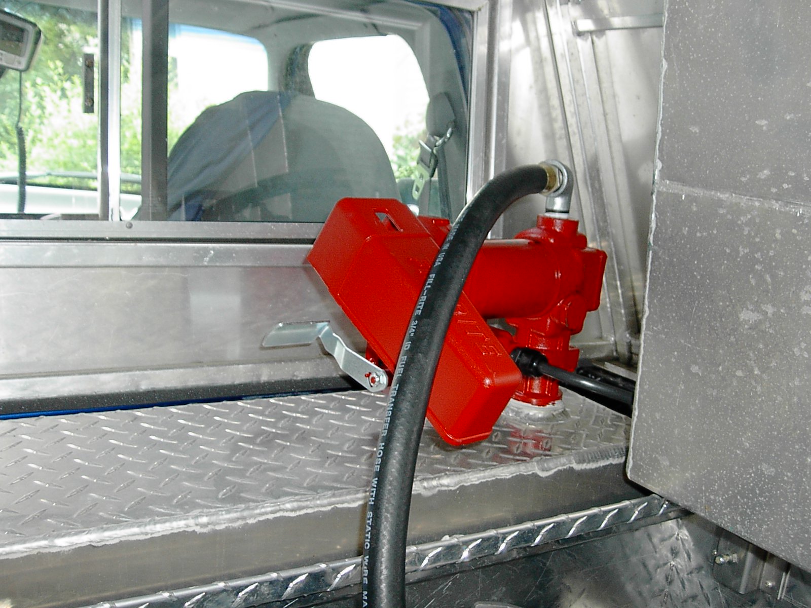

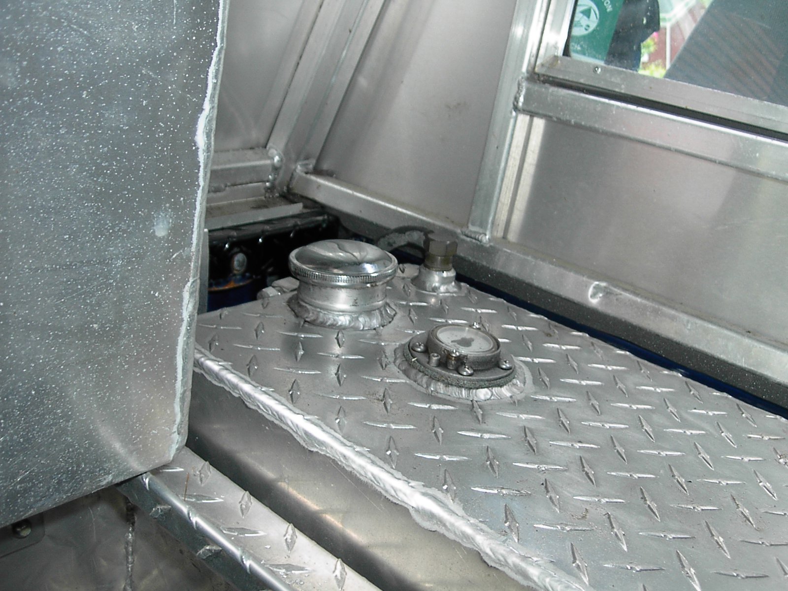

I have an aluminum tank / box combo in my bed, made by RDS in Florida. Mine holds 97 gallons. My pump is an electric Fil-Rite. Honestly, i don't have alot of gallons through it, so i can't really report on longevity/reliability. So far i'm plenty pleased though. One thing i thought was strange.... there are only two tabs on the rear of the tank for mounting(only two bolts through the bed floor hold the unit in). I would have expected four at an absolute minimum, but i suppose it would probably only matter in a roll-over situation, where the tank coming out of the bed would be the least of my worries. Anyway... i'm sure it was engineered that way, as perhaps they would want the tank to seperate from the truck in a rollover? Most of the steel tanks i looked at didn't stay looking good very long, which is why i sought an aluminum unit. I've not weighed my truck since it was installed, but i recall reading somewhere that my tank, full of fuel, would add about 900 lbs to my truck. Not a concern with my F-350, but it might be if it were a half ton.

For what its worth, i had intended to use a hand pump, since i didn't intend to fuel my tractor terribly frequently, but the price difference was about a hundred dollars +/-, so i went electric. Plus.... in my case my tank is under a contractors style cap. In the end i didn' tfigure i'd want to under there in 90 degree heat cranking or pumping manually. If bed space is a concern, obviously the tank-only set up would be better for you. Not only do i have an 8' bed, i also have a small dump trailer i use to haul the stuff most people have to put in their pickup bed. The bed of my truck is usually reserved for tools, chainsaws & whatever.

Wiring is supplied with the pump, Fil-Rite, and is pretty straight forward. If you have a steel tank then the pump threaded into the tank top provides the ground. My aluminum combo tank required a seperate ground wire to the truck. The pump motor is wired directly to one of the truck batterys with a fuse in the line.
Pretty simple install.

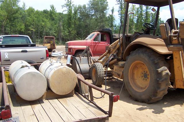

I can't comment on the tanks, but I do have a 12 volt pump from Tractor Supply. They had two models to choose from, and I bought the cheaper one. The big difference from what I remember is the more expensive one had auto shut off on the handle. I have the cheaper one and have to hold the handle while fueling.
I've had it about three years without any problems. It's kept outside 24/7 without any protection on a trailer that I mounted two 100 gallon saddle fuel tanks off of semi trucks.
I put a Napa inline Fuel filter on it that I have to change about once a year. Just because the filter needs changing, I know it's doing something, so I'd highly recomend putting on a filter system to whatever pump you buy.
Eddie
