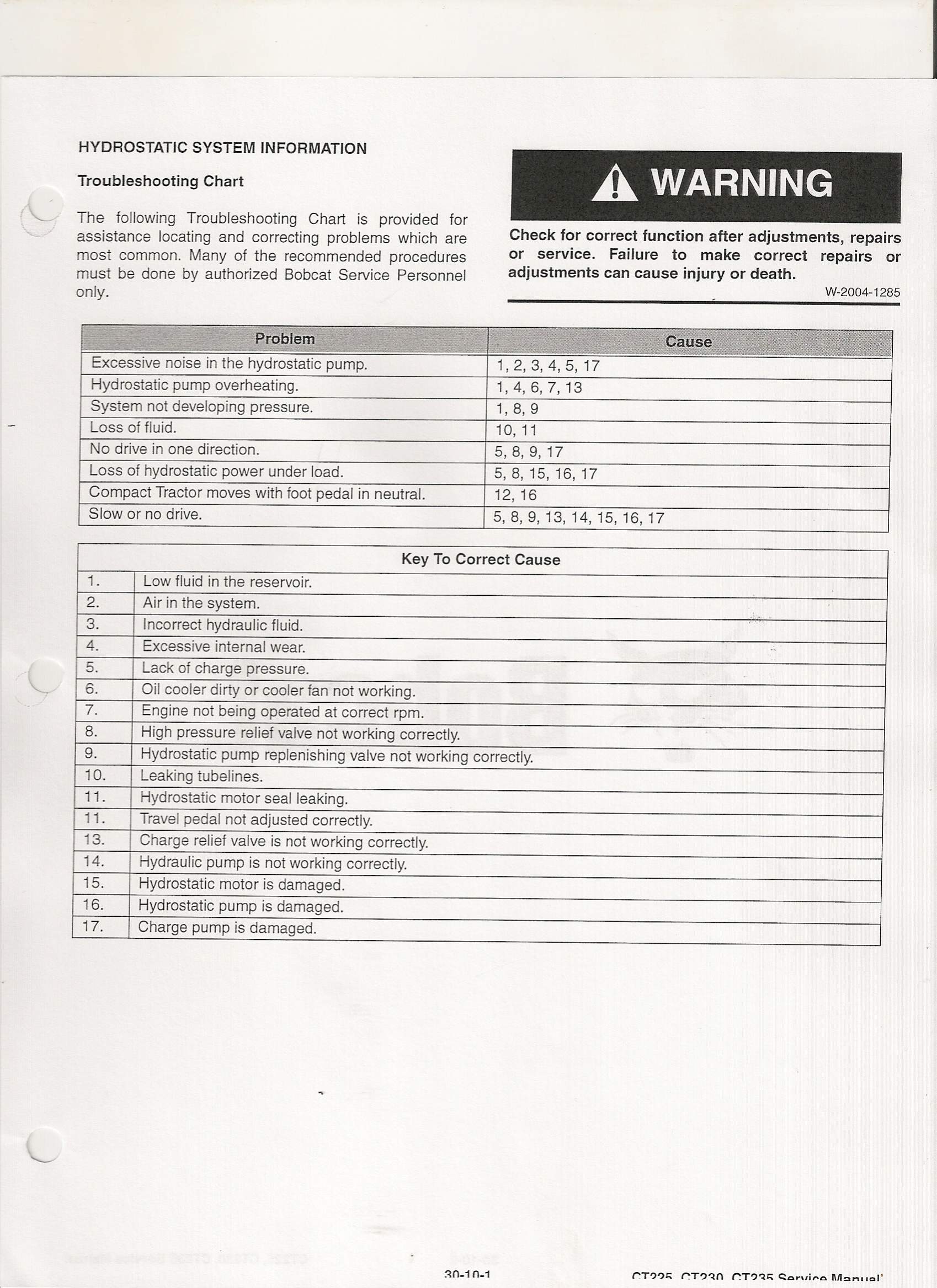

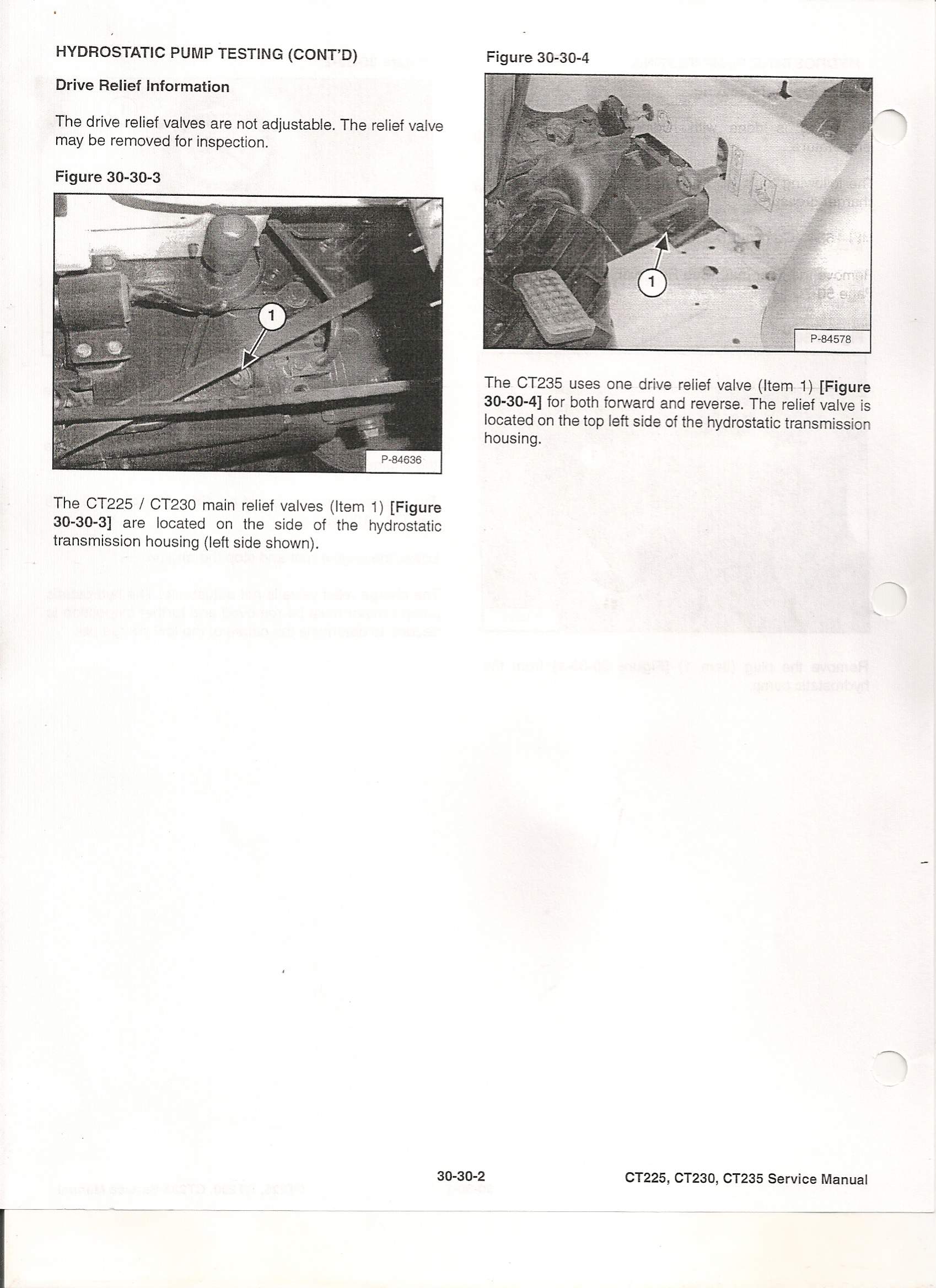

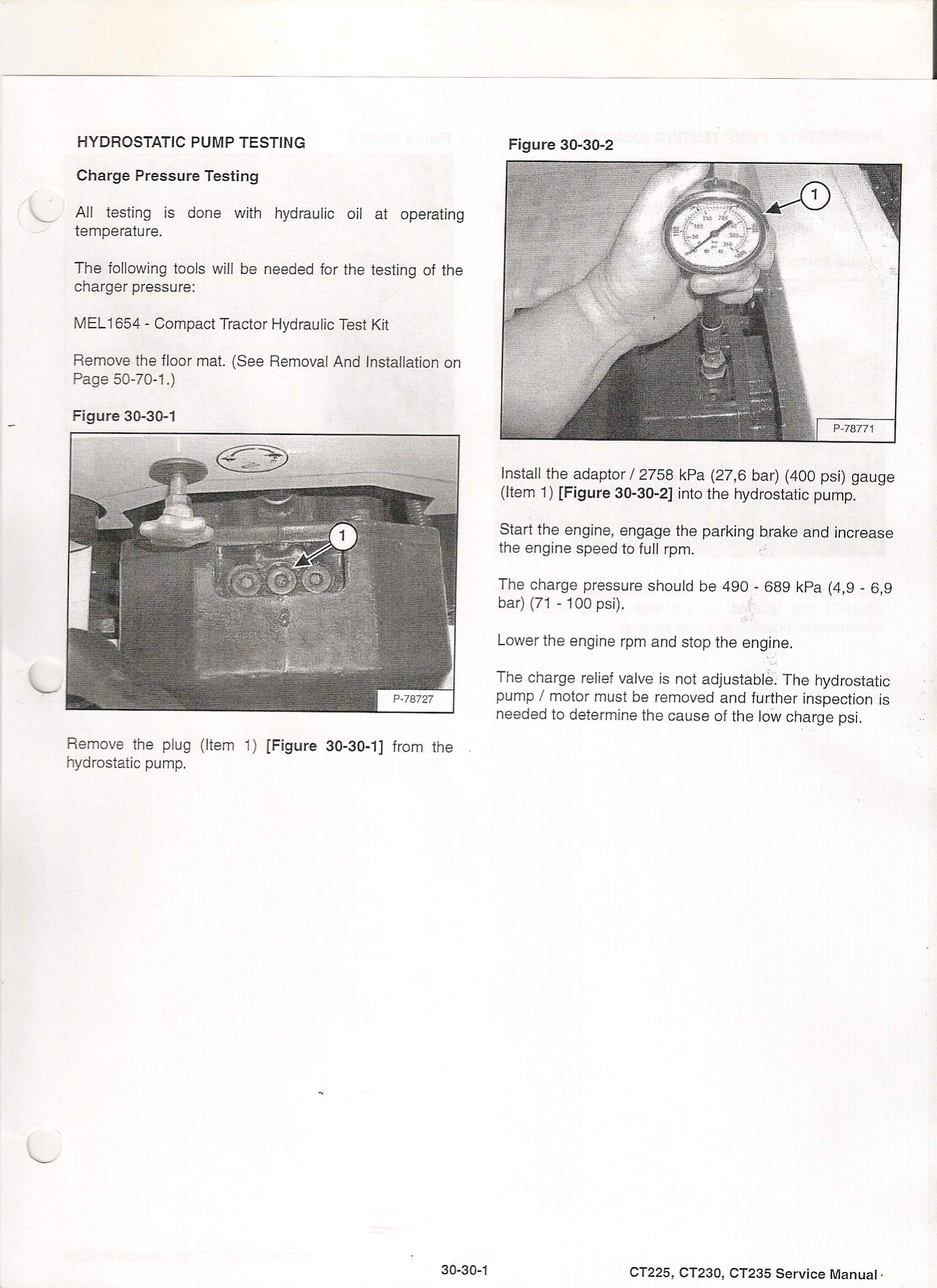

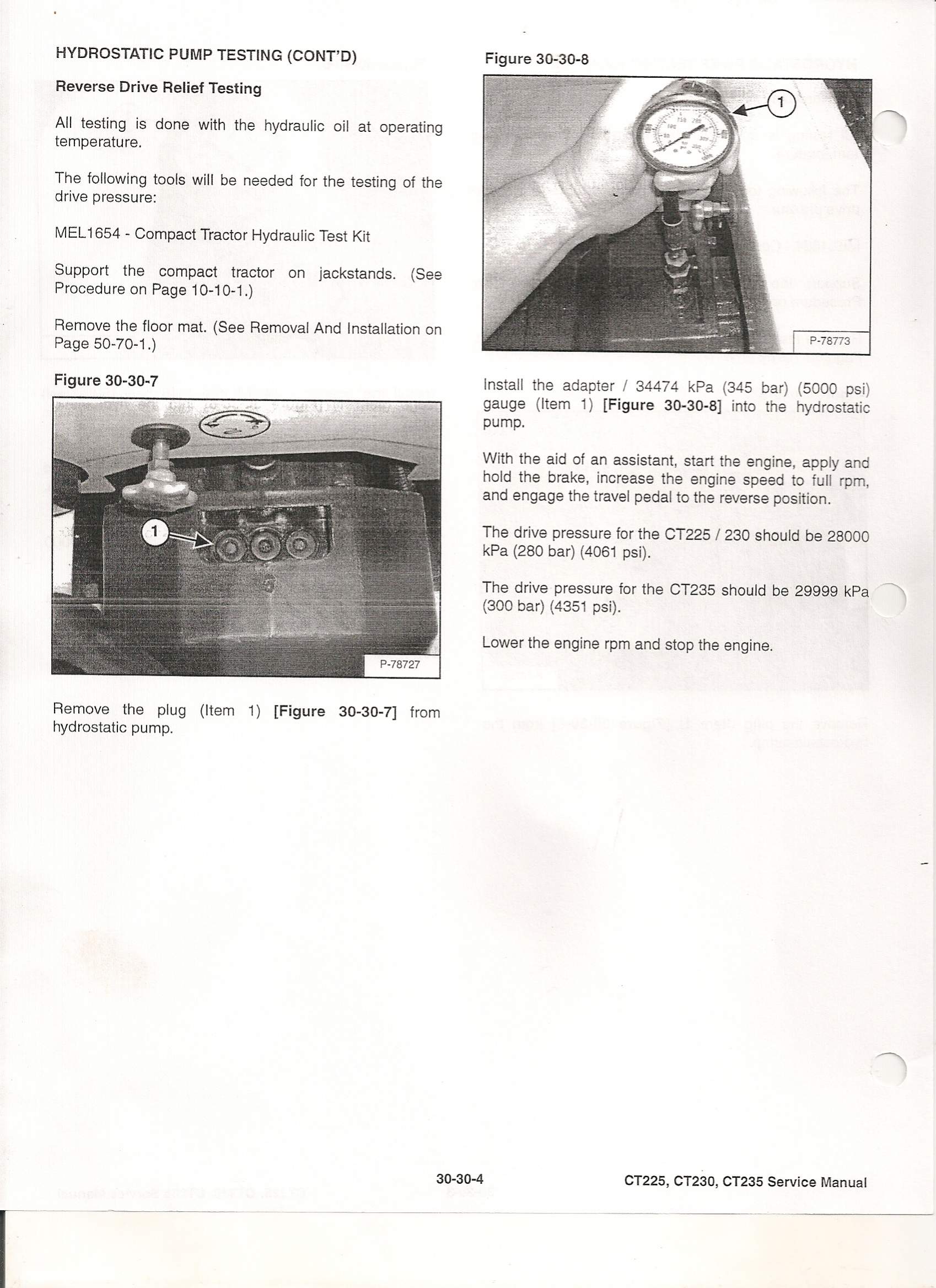

   / Troubleshooting hydraulics #3
Here is the trouble shooting page out of the CT230 repair manual. I suspect one of the things listed under "Loss of hydrostatic power under load" will be your problem.There are 3 test plugs that can be removed and a gauge installed to do testing. There are about 4 pages in the manual covering these tests. They call for a "Compact tractor hydraulic test kit". I think finding out the thread of the plugs a person could rig up their own test gauge. If you think you might want to make these tests I will scan the pages for you. I gave $109 on ebay for my repair manual. Don't know just how mechanically inclined you are so give me feedback if you think the pages might help you
Went ahead and scanned the pages for you. They are in reverse order.

This is great. I am sure I can come by some gauges to test this. I run between 2000 and full RPM when doing work. Lately having to run at higher RPMs to get anything out of the tractor.

Sometimes its the easy fix. This time it turned out the brake was not releasing fully. It would come off the parking brake and come most of the way back out. Took my foot and pulled on the pedal and the tractor comes alive. I was just about to order a 0-5000PSI gauge and thought I better check the obvious. Thanks for the thought.
I did grease the zirc on the brake to see if it would help. It did a little but still have to use foot to get brake fully out. Will look more into adjusting it this weekend.
