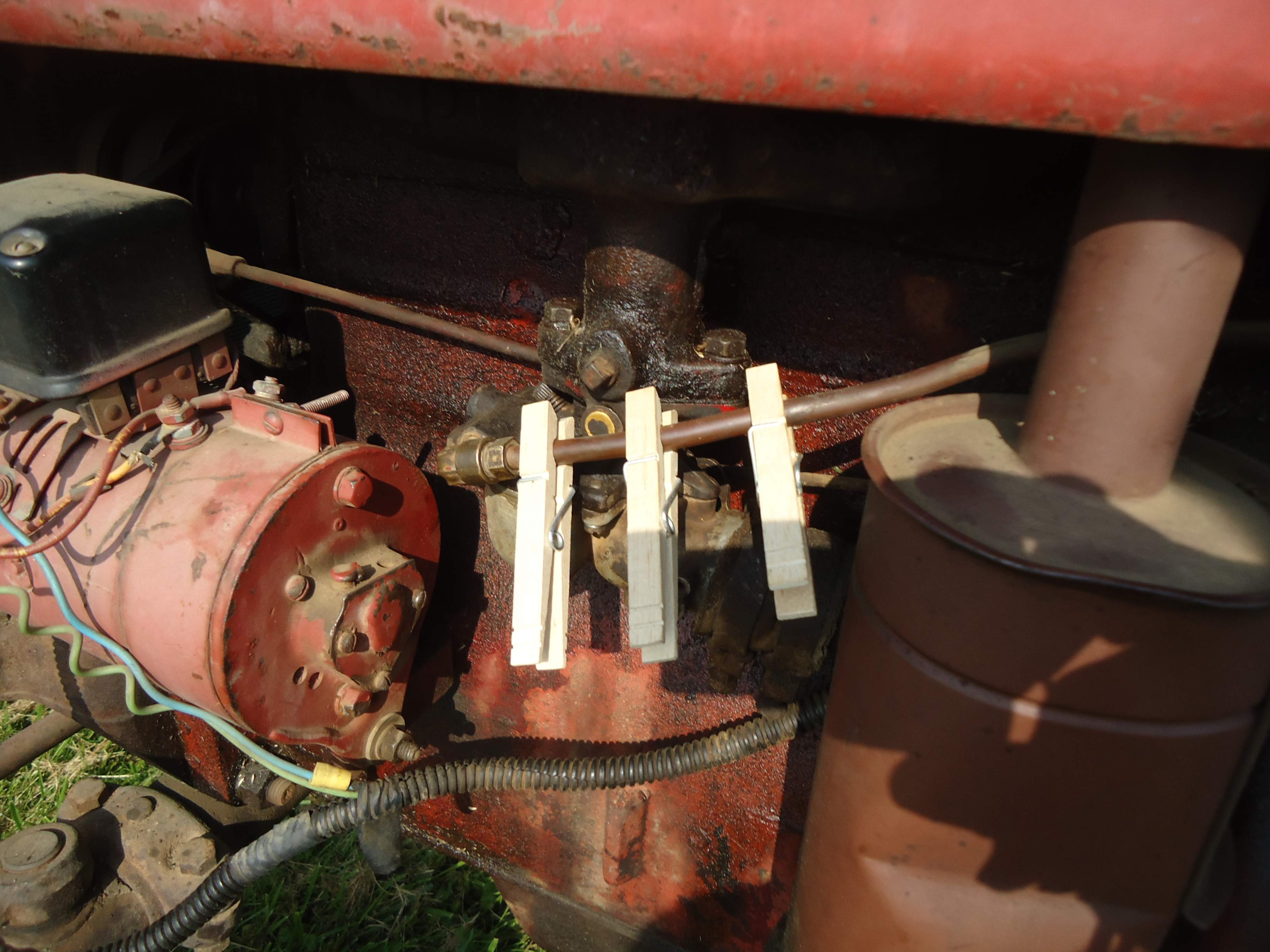

#3. If the temperature was in, say the low 80's outside, and you're pulling it pretty hard, there is a possibility of it vapor locking. Without knowing the temperature when you're mowing, how hard it is pulling, and what type of fuel line, or how close it is to the manifold, this is merely speculation. I have had my Farmall A vapor lock on me mowing with the rotary cutter, on a hot day. IF that is the problem, it's a pretty easy fix. If you have any of the wooden, spring type clothes pins, clip 3 on the fuel line, between the air filter, and carb., and it will eliminate the problem. Ask any older Ford guy about that fix. It was pretty popular for the early 60's cars & truck with vapor lock problems.

How long are you having to wait before you can re-start it..?? If it has to pretty much cool completely, then I'd say vapor lock. As mentioned, and easy fix with several clothes pins on the fuel line, like in the picture below. They act as a heat sink, even though they are made of wood. You can get a whole bag of them at Wal-Mart for a few bucks.
