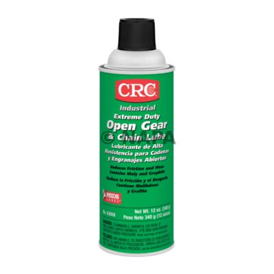

I find that heavy grease just collects dirt and trash making a sticky mess. Have been cleaning the pto shaft and couplers and then spraying each with wd40 before attaching. This seems to work much better and is easy to slip on and off.
NAPA sells in a aerosol rattle can, Chain and Sprocket lube. Somewhat pricey but does not attract dust and dirt like grease and does a wonderful job of lubricating PTO slip shaft collars. I think it is better than WD-40.
