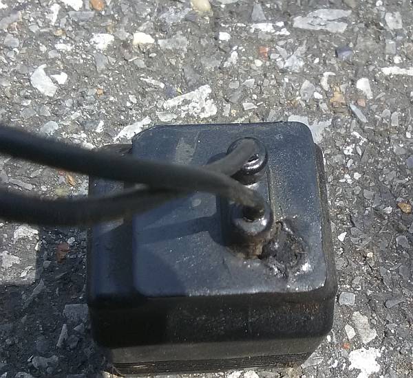

It's that solenoid. Picture below. Obvious burnt spot next to the wire input.
Bugger to get out. Requires removing the left wheel and BH 4 point bracket which is about 7 bolts and goes nearly forward of the brake pedal. Then re-torquing everything after reassembly. Solenoid body slides over shaft in PTO and was difficult to remove. Thought it might be swollen from heat.
Dealer is going to borrow one from another machine on their lot so I can get it without having to wait for shipping, but it'll be Monday before I can get it.

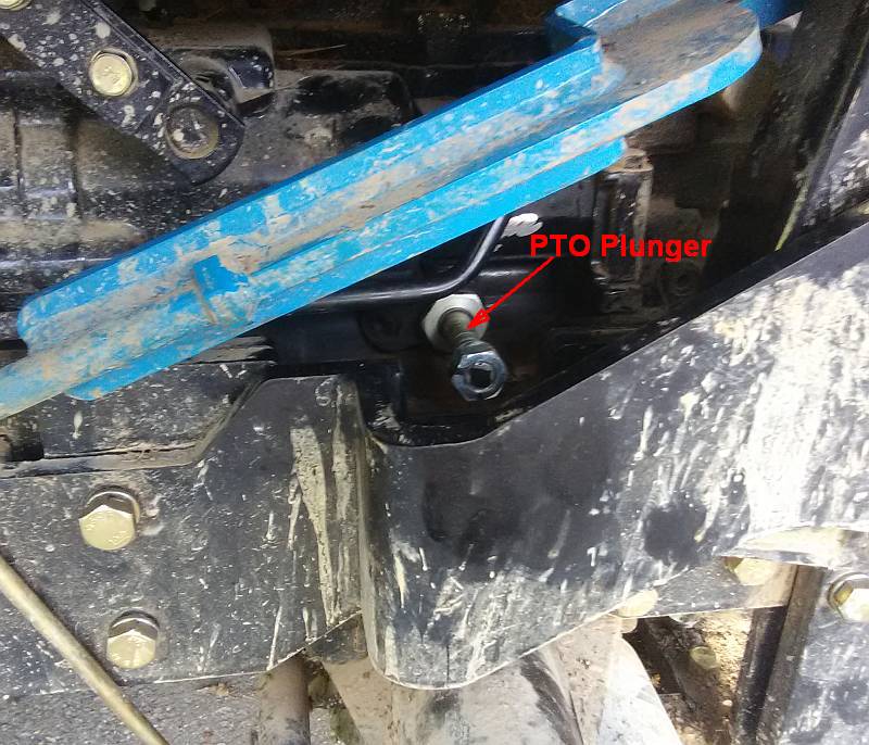

This is the stud that the coil slides over, held by that one nut shown.

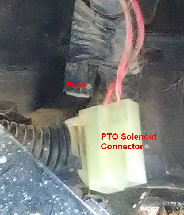

There's a pigtail on the coil with a two pin connector that plugs into this harness connector located to the left and above the coil. There is also a fuse in that bundle, so I'm not sure why that didn't blow.

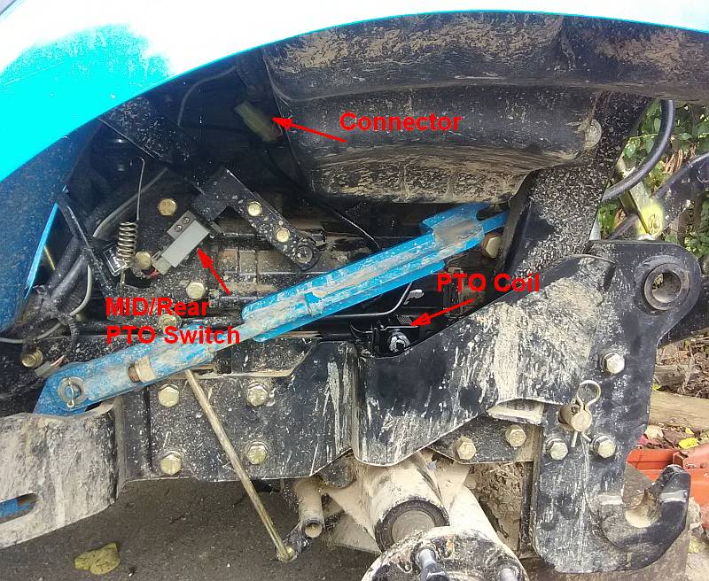

All tucked back in place. Seems to be fine, but will test under load tomorrow or Wednesday.
