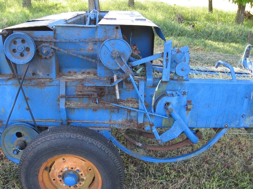

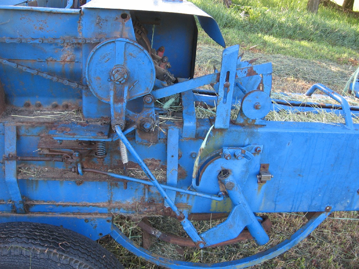

I'm attaching 2 photos. One (on the left) shows the needle rod/wheel in the proper resting position at about 5 o'clock. The other (right) shows where it is when incorrect, at 6 o'clock--not past the plate that is spring loaded and catches it.
I hope these help. I have been baling with the cover off so I can see easily when it misses a full rotation, although it is easy to hear it kicking about back there.

These pictures show that the needle brake is not tight enough. The needle brake is the 90 degree sector that is around the needle hinge shaft. There are two bolts with springs on them. These clamp 2 disk brake shoes to the disk, just like on cars. These bolts usually have lock nuts or are double nutted to keep them in place. In fact, the brake disk is still pretty rusty so its not even a player in the needle safety equation. Since this is a Deering knotter mechanism, its virtually identical to the early John Deere types. So, that being said, the John Deere operators manual advises to disconnect the needle lift link, set the needle frame to a vertical position, and adjust the brake shoe tension to deliver 17 - 22 lbs of rearward horizontal force. If you get it too tight, there's gonna be some bad noises, one from the machine and one from the operator.

I'll bet this fixes the first issue. The billhook stripping is a wiper arm adjustment. If you remove the wiper arms, you can easily sharpen or replace the cutoff knives. New ones will come with bolts instead of rivets. Grind off the rivets, sharpen them and reinstall either new or sharpened parts using bolts.
BTW: looks like there is another spring in those pics that needs to be changed. Home Depot has them. Also check the plunger safety stop springs and free the channels in the lower bale case of chaff, crud, rust, mice, twine ends and other stuff. Then you won't have to weld the other needle. Good luck. Let's hear back on how all this works. (We expect paint to be applied, too. Its a pride thang....)

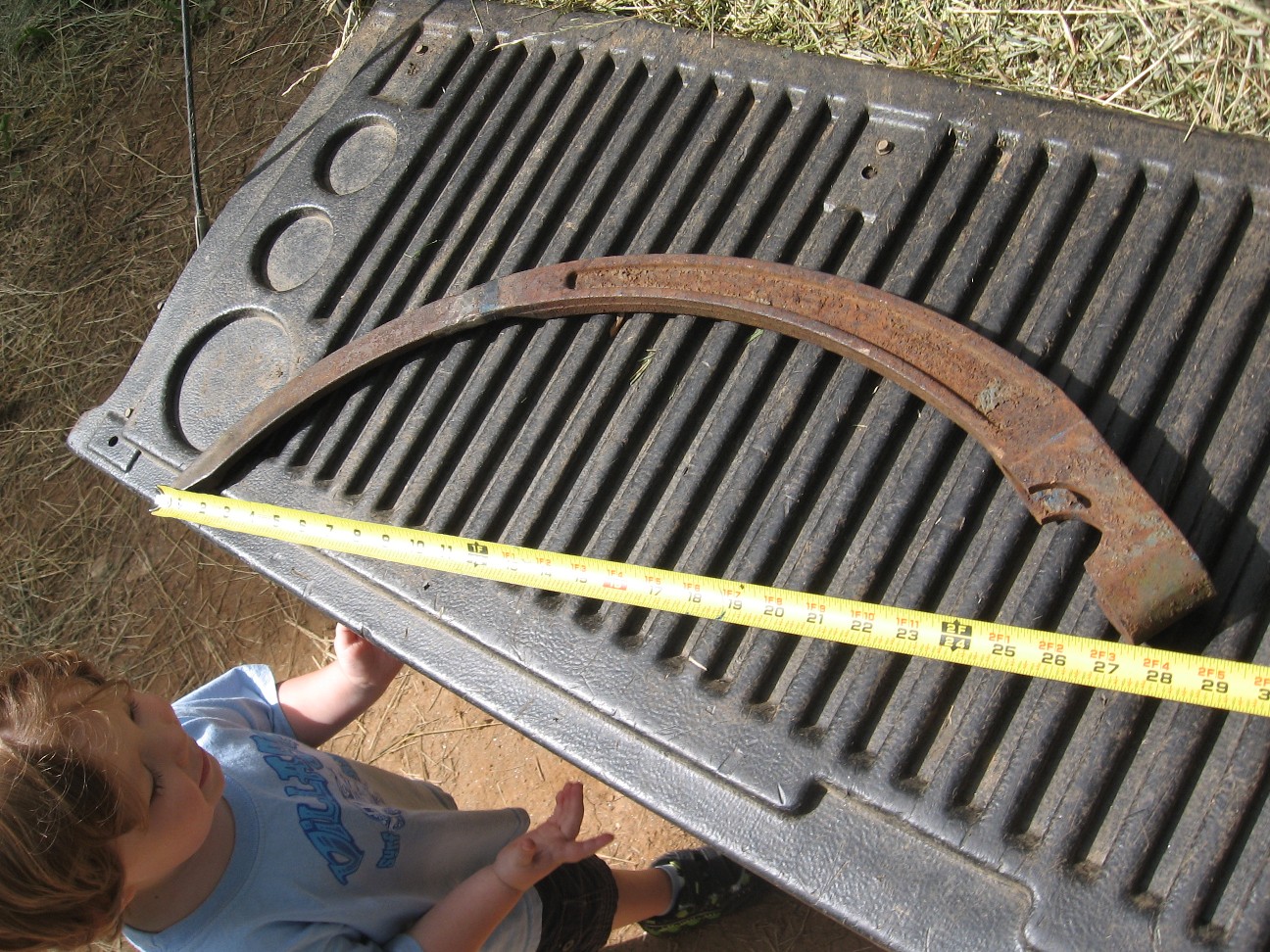

What's the tip to clamp distance on a Ford needle? I have a 14T and a 24T needle. I can compare them to yours.
/ trouble-Ford 532 baler
27 1/2 inches from tip to clamp as shown in the picture below--I wondered if you meant straight instead of along the arc so I snapped a photo to be sure we were on the same page.

The 27 1/2 inches is about the same as my 14T needles, but the 24T needle is about 29 inches and the curvature is different.
The needle brake disk is that circular slotted flat plate not 8" from the bale counter in both pictures. There are 2 bolts showing with springs on then for brake tension. I don't recall seeing this in the parts diagram but what is important is that it is right there on your baler on the needle shaft. Since there is paint and rust on the brake disk, I would guess that the brake is not even engaged. The slotted guide should shine like a car's brake rotor.
/ trouble-Ford 532 baler #10
OK, so they don't call it a needle brake, its referred to as a needle retarder. There is brake facing material on it. Maybe yours is all gone. Glue some sandpaper on it if that's the case.

Without the needle brake working the needles won't stay in the home position in the field, I have to say my JD336 (same knotter almost) which has a needle protection feature broke a lot of shear bolts before fixing the brake. A bump would let the needles move which drew the blocker in front of the crank arm and ker-snap. Better than needles but still a pain.
/ trouble-Ford 532 baler #15
Now that I've studied your photos with both eyes open, it looks to me like the main culprit is the marginal condition of the plunger stop mechanism. Its the "bent rod" parts. The pics also show that the plunger stop engagement spring is all but failed, too. Get a new one (TSC or Home Depot/Lowes/Manards), straighten the rod, and free up the plunger stop with oil/grease and a new pin or bearing or whatever makes it stay in position and you will be back in business without the worry of a snap or a boom.
