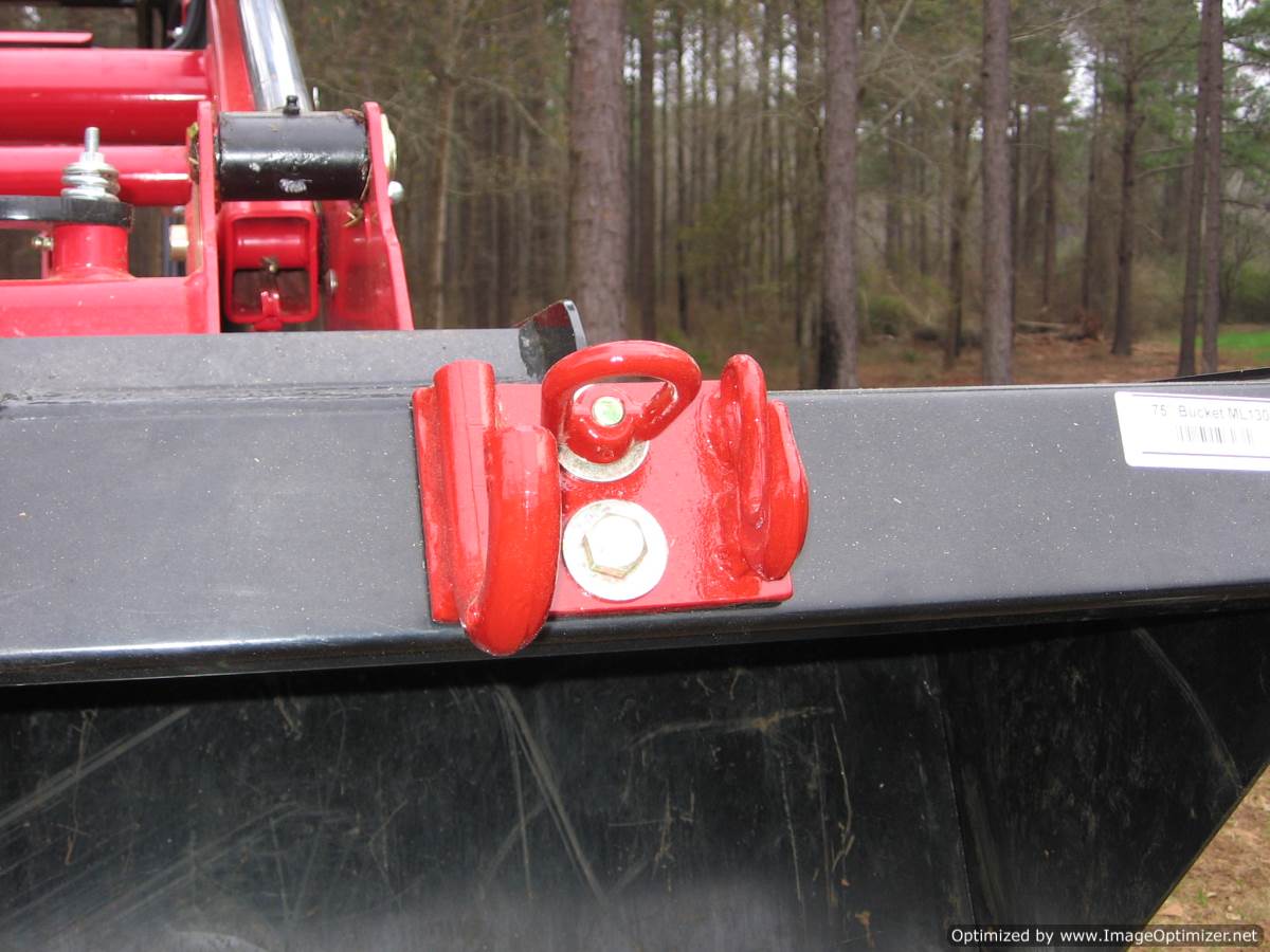

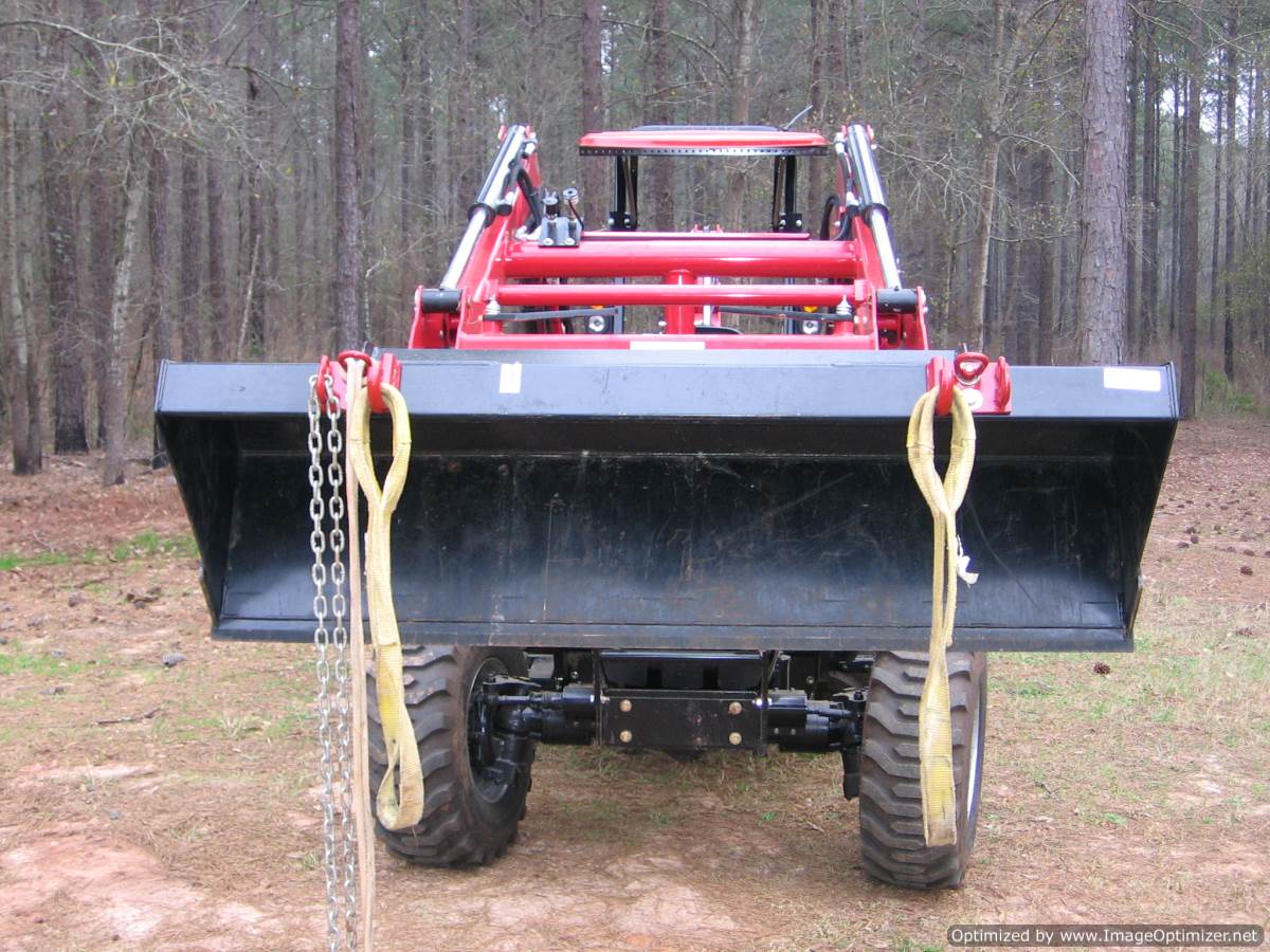

I made these bolt on plates with chain hook,sling hook and clevis ring.I use the slings more than anything else for my lifting needs.

Thanks.I made them out of 1/2x6in flat bar,1in oval lift ring sawed off set in half to make the j hooks,3/8 chain hooks off an old chain buck and a lift ring off of I don't know what.Im blessed to have an over abundance of stuff just laying around waiting to be made back into something useful and handy enough to make it happen.
