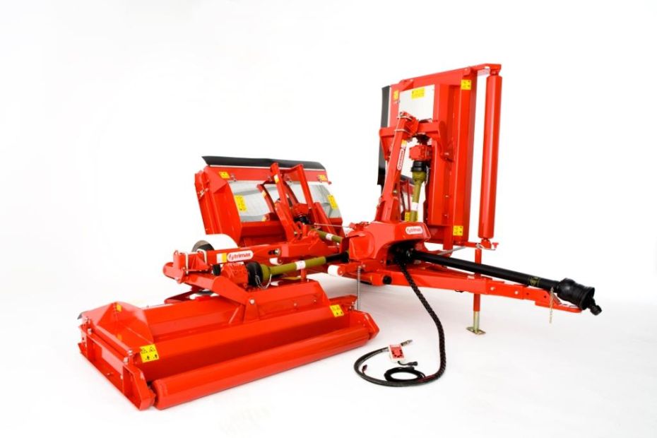

Any tips and tricks on raising the cutting height on a Trimax Pegasus Series 3 its an old unit and the adjusters are slightly worn. I have been told you can place wooden blogs underneath the cutting unit's and try and raise them any help would be appreciated...

Greetings from across the Pond hawkmoon2263,
So you have a Pegasis series three roller mower??????????????????????????
If the threaded rod height adjusters are shot you need to replace all twelve sets of them and use nylock nuts to prevent the adjustment nuts from freezing stuck with rust.
If they are really bad you will have to just hack saw them off and replace them with the new ones.
A reciprocating saw(sawzall) is the fastest way to to do that.
