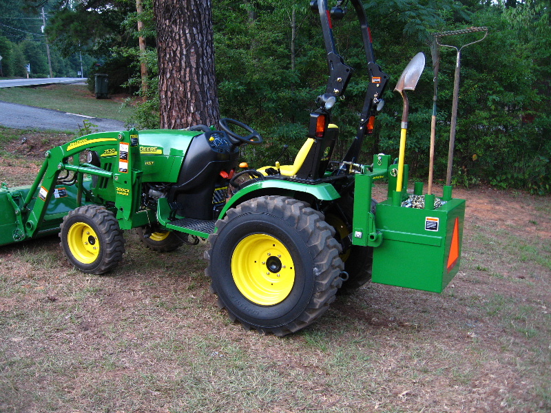

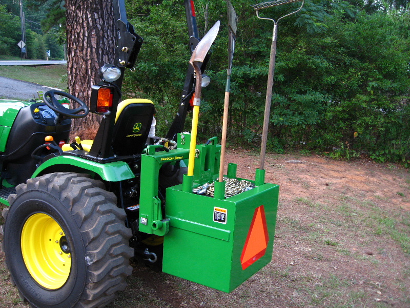

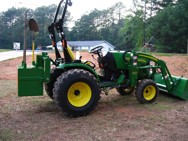

Boy mayor really had a good idea when he done this. used the new porland filled balist box today. man Johnny D is planted pretty good doing loader work...:) also used my tool carrier to carry rakes and shovel up to the front yard to work, it worked really great. the 2 1/4 inch pipe worked great tools dont wobble around to much. notest how i just poped chains out of the pipe . thay fit good right on top of the rubber mat. this really works well. ;)
How anyone can get along without a Tractor is beyond me...:p
Chris...:)

Nice work Chris - I'm debating on whether I put the pipes in mine before I fill it - yours looks very nice and quite functional. Hmmm....

Did something similar with my 2320. Your 4 pipe looks really good.
I have to admit I painted my #2 shovel green and yellow as well as the chain.
Great job you did!.

Chris, I saw your earlier post on this project and wanted to ask how big did you drill your drain holes? I'm going to fit mine up the same way, looks great.
   / Tried out the new weight box and tool carrier
5/16 drill bit....;)
Chris...:)
