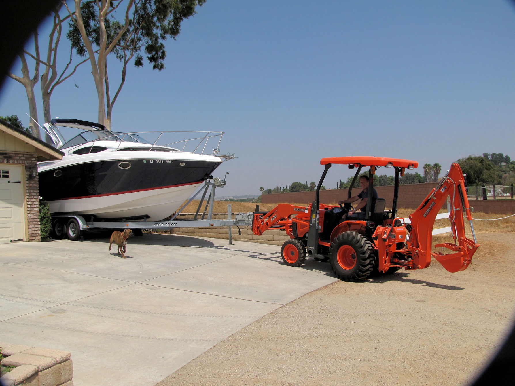

My 2007 triaxle boat trailer carries almost 10K lbs of Regal Cabin Cruiser. With the trailer weight the tires are carrying approx 12.5K lbs. The Carlisle D rated tires on my trailer are starting to show significant sidewall cracking. My calcs indicate the D tires are fine for this load, although most local tire dealers are recommending an upgrade to E rated tires for extra safety margin. I'm all for extra safety margins, however, the wheels (Carlisle 15x6 6 bolt spokes) are rated to 65psi (the D rating). So to take full advantage of the E rating (80psi) I'd need to upgrade the wheels as well. Options:
1>replace with D rated (NOT Carlisle's)
2>replace with E rated, keep existing wheels
3>replace with E's and new wheels rated to at least 80psi
Option 3 is roughly twice the cost of options 1/2. What think ye towing experts?

Don't you have plenty of "safety margin" with just the D range tires?

If you do upgrade to load range E, they need to be on rims rated for the pressure.
Do you physically have room to go to a slightly bigger tire? That would also increase the tire's load carrying capacity even for the same-letter load rating.

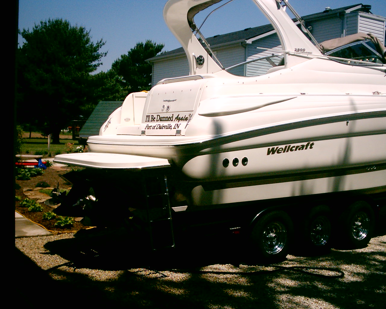

I deal with this all the time. Its not that they are D range or E range its that they are Carlisle tires. They are absolute Junk. Get a set of Green Ball Tow Master Radials or some other brand that has a good rep. I have the worst luck with Goodyear and Carlisle and have been having good luck with a lot of the Chinese tires and the Green Balls the last couple of years.
I ran into the same issues the same year I bought my WellCraft. It weighs 15,600# and I blew 3 of the 6 tires in one trip when it was only 2 years old. Switched over to the Green Balls and zero issues in 3 season and about 3,000 miles of towing each year.

If my math is right each D tire is carrying about 2.1K lbs and they are rated around 2.5K lbs, so yes there is a safety margin. The E tires would add another 300-400lbs at 80psi.
Not really enough room unless I do some weird stuff with the axles.

Nothing wrong with going the safe route but I run Load Range D on the boat pictured above. The trailer is a 18,000# Eagle with 3 6,000# Dexter axles and it does just fine. Like I said the boat weighs in at 15,600#. I have weighed it.
If you have to do stuff with the axles just be aware there is more to it than you think. Axles have a built in arch. They are also directional since the brakes have a left and right side. I am assuming you are talking about doing a axle flip. To do this right you need to have a axle flip kit installed. Watch your height. My boat sits 13'6" high as is so raising it would cause problems with bridges and such plus you raise your CG which may cause trailer handling problems. One other consideration is if you raise your trailer you will now have to back it in farther. This may put your truck in the water and with that type of load I do not like to get the rear wheels wet. Just some things to think about. I have been down this road before. If it were me I would get the Green Balls or some Denmens in the stock size and be done with it.
