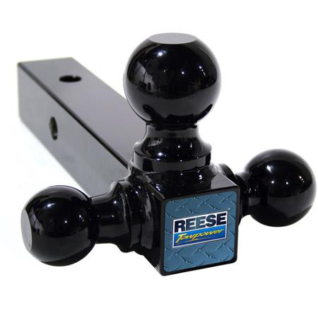

I live with multiple trailers, yard trlr ..1,000 gvw, boat 1,000+ trlr, (1"7/8). RV, 8,000 dedicated tow/sway set-up and now my flat bed 7,000 flat trailer for my tractor. What do you think of them in terms of safety and on the road confidence? Thanks:confused2:

I personally don't like 1 7/8" couplets and balls. I simply replace the coupler to 2". Cost so about $12.
Then I use a dedicated bar and ball for 2" and one for 2 5/16" stuff.

If you're talking about these, they work fine. They are rated and that should be that. I've had one for 14 years. Its handy if you have multiple trailers, or, if you are asked to tow a friend's trailer, or, borrow a boat, or take a kid to college with a U-Haul, etc.... :thumbsup: $28.53 @ Walmart.

That's exactly the item I was looking at. I also use a clamp hitch on the Fel to move the trailers around---thought this might be handy with that and with the truck.

The big problem with using straight tri balls with small trailers and larger vehicles like pickup trucks is the hitch height...most time the tounge is lifted too far up and the trailer platform isn't even close to being level....look like a real amateur towing down the road like that. :rolleyes:
We have two to use where I work every trailer we use (my car hauler included) is different a size.
Personally I always use the correct drop and/or rise I need when I am towing otr.
Of course on a tractor bucket all that wouldn't matter anyhow. :thumbsup:
Would be handier and less costly than having assorted ball setups.
I have one to sell...nobody bought it off my tool tables this summer, but they did buy all the assorted different sized drops and balls. One guy wanted to use it with 1 1/4 to 2" adapter I couldn't imagine why he would need 2 5/16! :eek:

Those are functional but, man, they sure look hideous. :) Every time I see one on a pickup driving around I smirk and think; "What a confused driver".

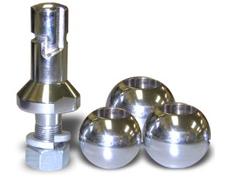

I use a Switch Ball setup. Mine is older but looks like this one
