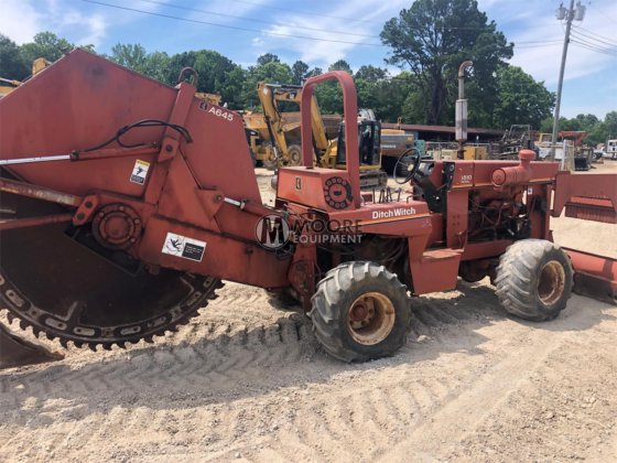

If the ground is real bony with a lot of hard rocks the rock wheel is ideal, the chain trenchers with the rock teeth will work.
Used Rock Saw Trencher for sale. Ditch Witch equipment & more | Machinio

For several who advocate to use a trencher, that's good advice in the soft soil in N. California. But not good advice in the hard soil of N. Nevada. At least not for my specific trencher, a Ditch Witch 1030 walk behind. I hauled it 100 miles on a trailer thinking it would be perfect. It wasn't. I nearly broke the trencher and/or broke me, getting only about 30-40 feet done before I threw in the towel. To finish that job, I had to hire a manual labor crew who hand dug using shovels, large bars, and an electric jackhammer. They pretty much jackhammered every inch of trench, with more workers coming behind with a bar and a shovel to finish.
I will look into the rock saw, or rock saw teeth that might fit my trencher. The submerged boulders, basketball sized, cause my walk behind trencher with standard teeth to buck all over the place at the edge of going out of control. And the cantaloupe sized boulders get jammed in the worm gear that is supposed to pull the soil away, causing instantaneous shutdown. Getting started again means prying those out using a 6 foot iron bar, sometimes a very difficult task.
