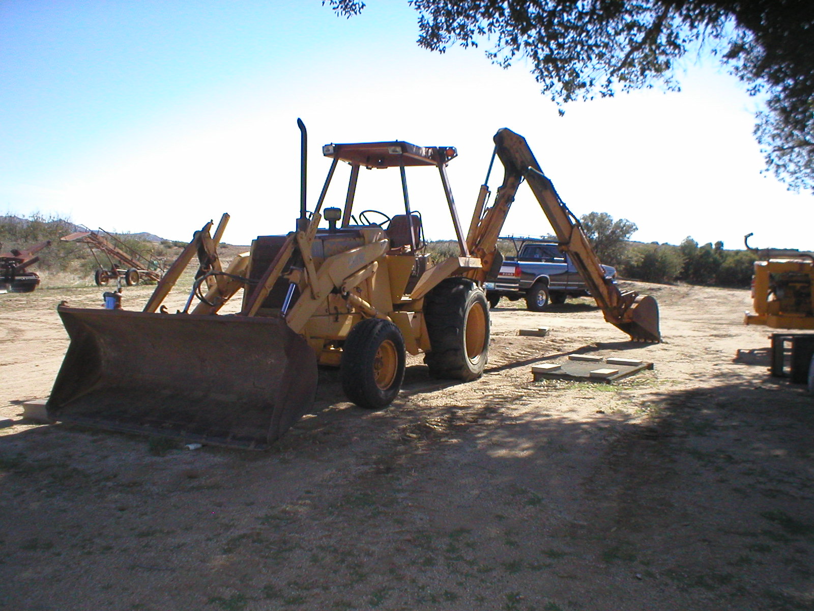

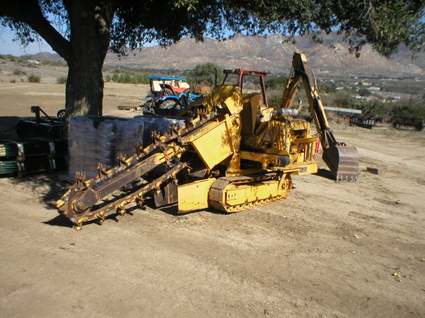

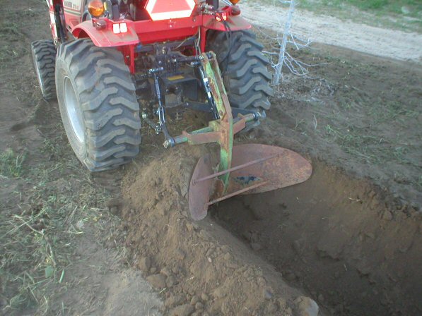

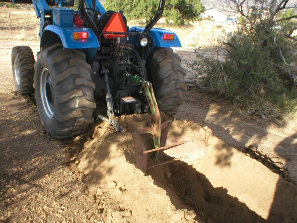

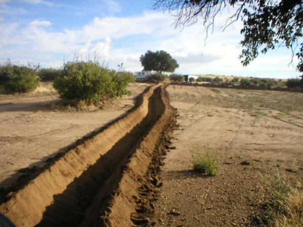

   / Trenching question #6

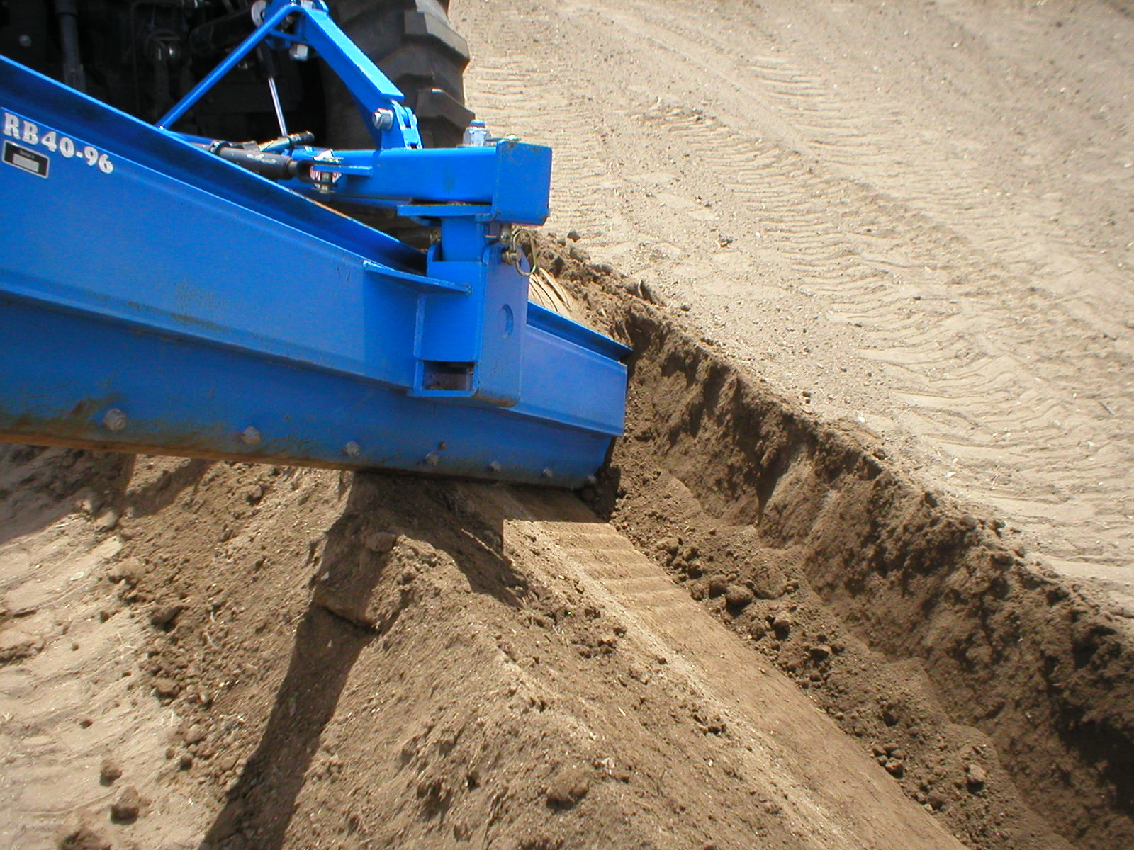

Obviously depending on soil conditions, but I pull 19"deep trenches quite easily. I always just pull at an idle and normally when the ground is damp. A 300' trench is done in less than 10 minutes.
We have an back hoe, trencher ,ditcher and a rear blade that we can trench with. Ditcher is my preferred method for off shoot water lines. Quick and easy. :thumbsup:
But if you need to go 24" deep, a ditch witch will work very well for you and should really only take around an hour. As others have mentioned, if you have "stuff" in the ground, probably want to get a ride on unit.
Good luck. ;)
