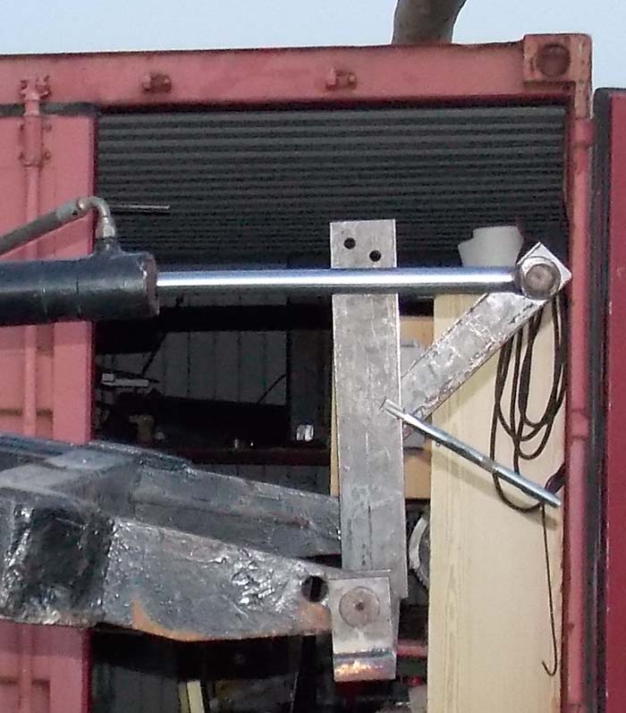

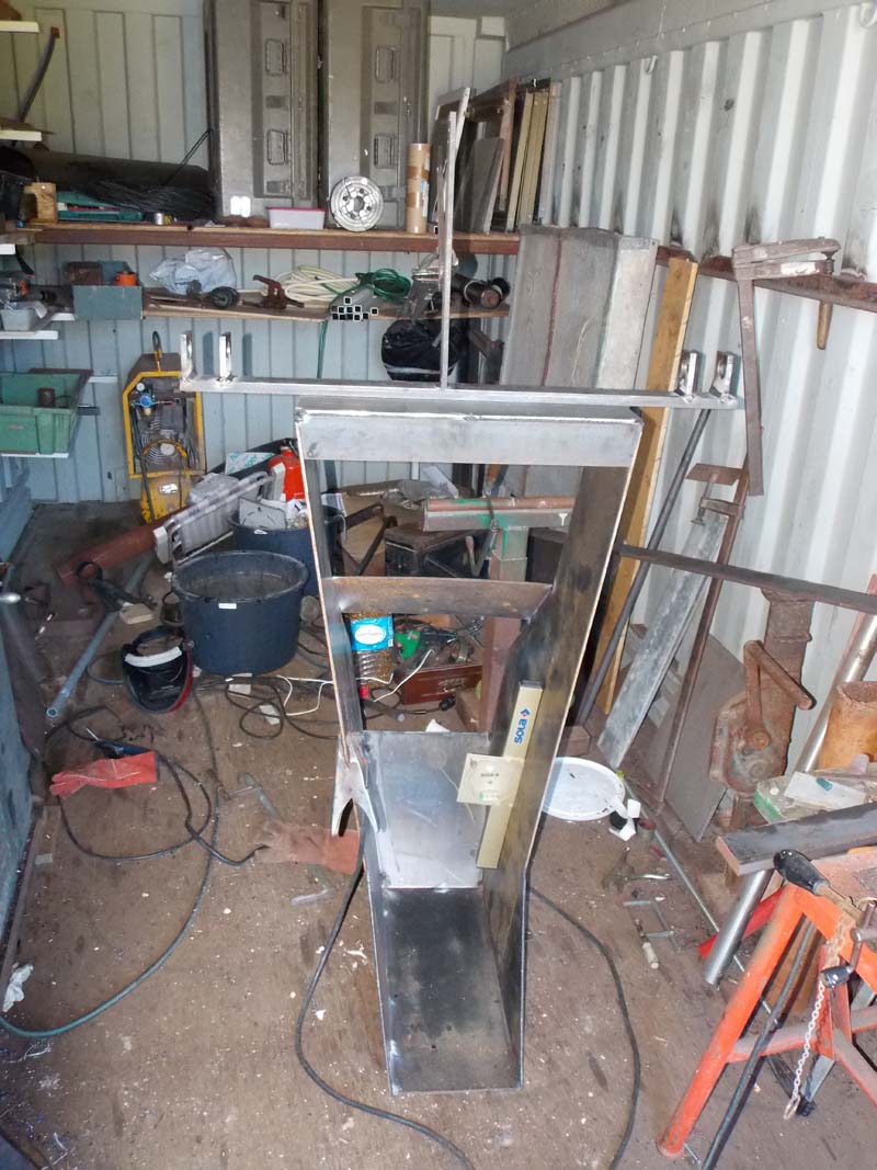

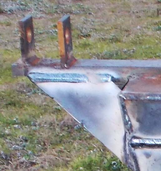

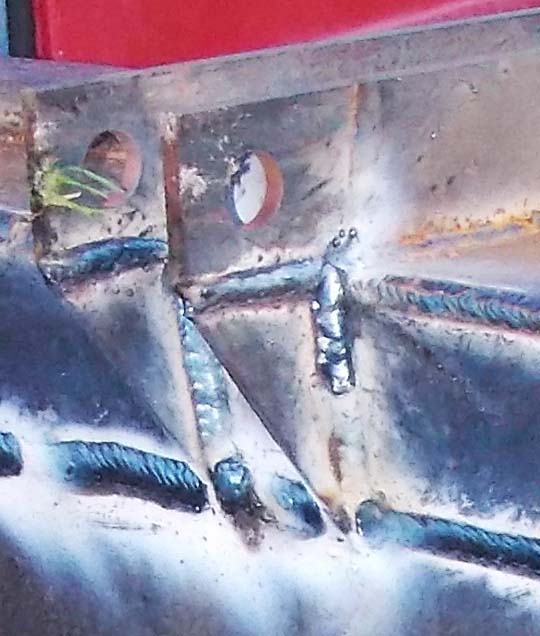

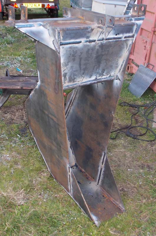

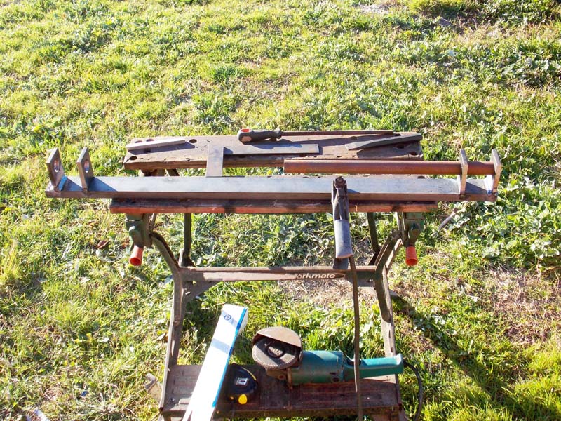

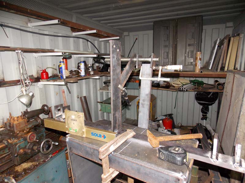

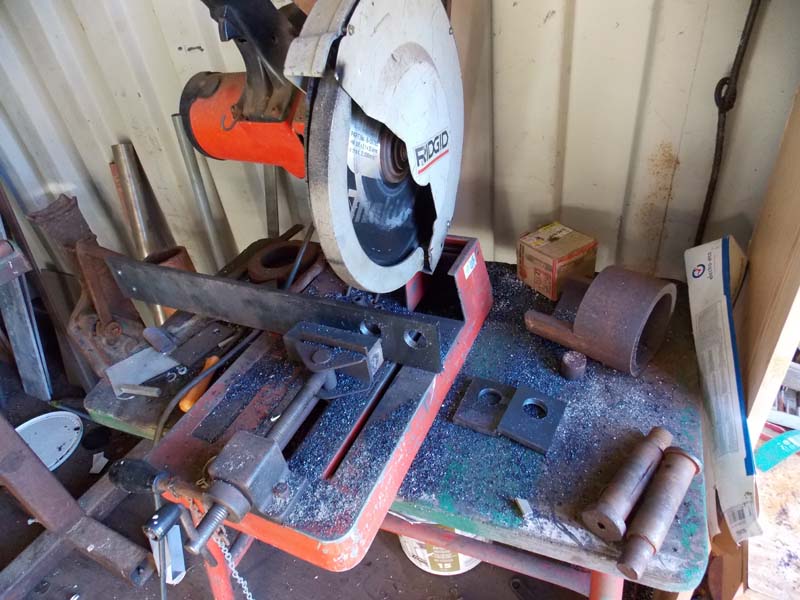

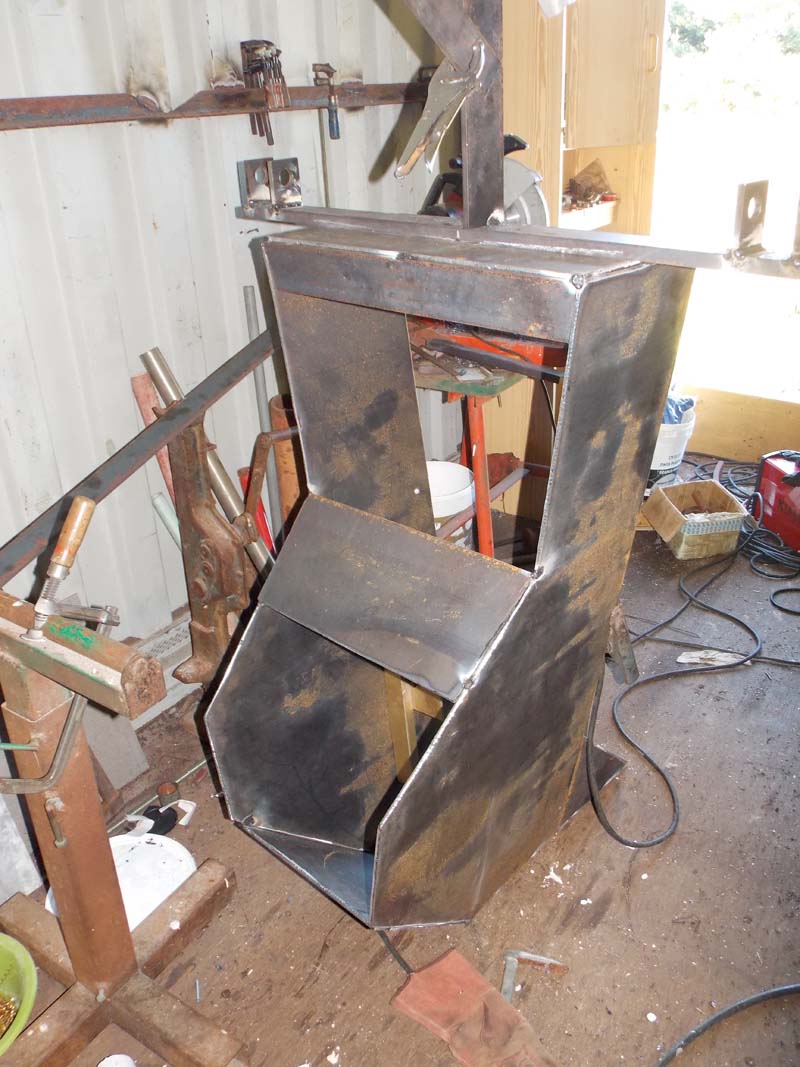

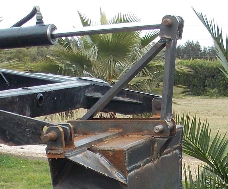

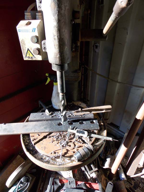

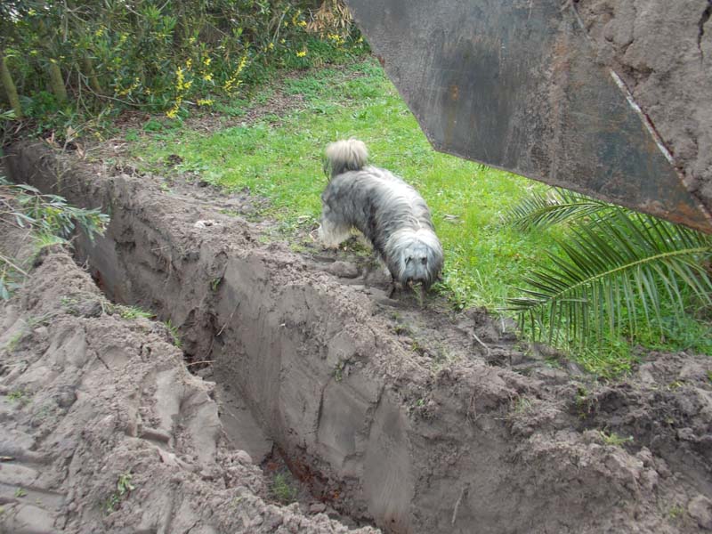

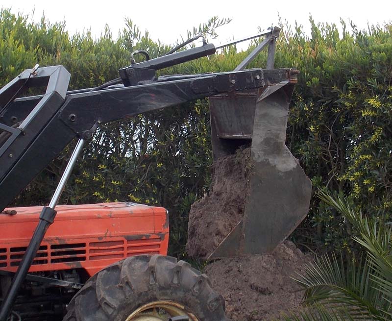

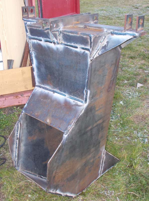

Just a simple thing, no moving parts.
It's reservable, so can be used forward or backwards.

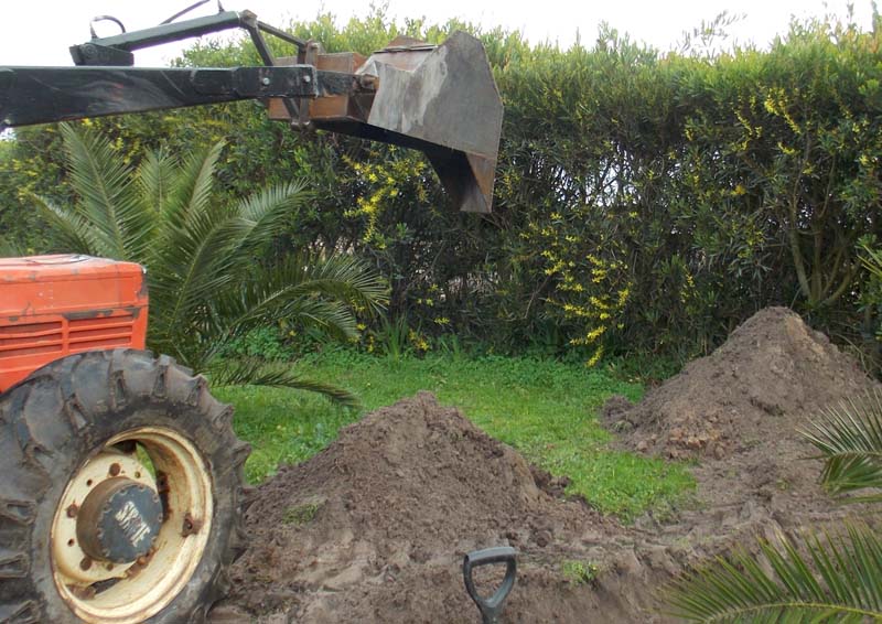

Thanks, everyone.
I was surprised at how well it works; but I do have really soft sandy ground.
I went through a lot of small roots, 2 irrigation lines, some clay and gravel, but it was mostly sand. My tractor is 4 tons and 4wd, but the bucket has nowhere near the power of a backhoe; I don't know how it would do on harder soil.
It will dig about 3 1/2' deep.
Here's a few more pics and a video.
