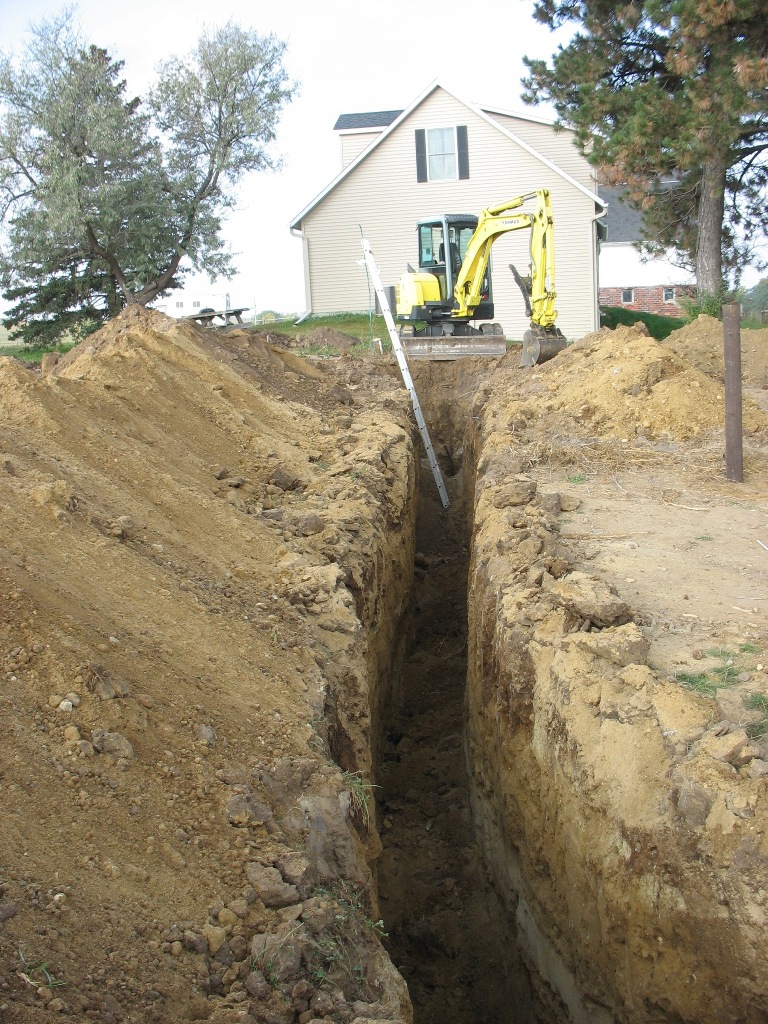

Considering that I will be laying a water line in a 6' deep trench this weekend could someone explain how you shore up a trench wall? What is a trench box?
   / Trenches #5
really it depends on soil type for how deep or how wide you have to cut the trench.
digging in clay, a 20' deep vertical wall will hold virtually forever (subject to water application aka rain/ground water) on the other hand, if you have sandy soil youll be lucky to get a foot or 2 without it starting to collapse in.
as for your question this is a trench box.
NOTE the sandy soil type.
as for how wide you have to cut back your trench sides as to not have to use a box/shoreing. again has to do with your soil type and therefore that question cant be fully answered without that information.

Besides trench boxes there are many other OSHA approved trench stability methods. Benching or sloping the excavation, posts and lagging and hydraulic aluminum / carbon fiber trench supports.
I would highly recommend people look into the regulation (29CFR 1926 Subpart P) and maybe a safety publication like JJ Keller's OSHA Excavation Standard Handbook prior to engaging in earth work activities.

I dug this trench this past weekend. It is about 8' deep and I do not intend to go into it except at the ends where I sloped the banks enough that it could not cave in on me. I ran the water line along the top and tossed it in when I got to the other end. Once I get the electrical line in there I will back fill and be done with it.
