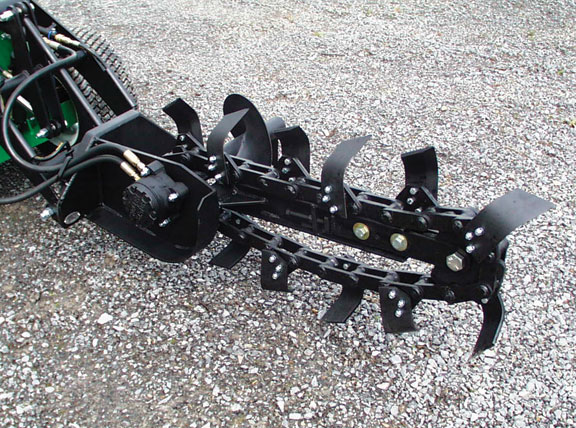

I have a friend that has a 425 powertrac and hes in a bit of a tight spot with cash. PT wants 500 for a chain and 115 for the idler and 90 for the drive sprockets plus tax and frieght. I can get parts aftermarket well they probably make theparts for PT from Atalnta Chain and roller co now Ballantine inc. I buy alot of scraper chains from them and they are very reasonable. I can cross refference the parts by measuring them but while the machine was torn down his sorry step sone scrapped the chains and sprockets I was wanting to know if some one here might know the center to cenet distance on the pins and the diameter of the sprockets. PT didnt want to mention this to me only that it was about 750worth of parts. Ive put longer chains on other trenchers recently and it not been this high. Take care Taylor Lambert

My chain is worn out also, and when I called them about prices, it was way up there. If the chain is worn out, the sprocket is worn out. However, I am going to weld and build up the worn side, and see if I can get a little more use out of the chain. It's to bad they don't make replaceable links, or maybe somebody does. . You could just build your own, or replace any defective link. [ PT's insider ], Now don't tell the customers where we get our trenching chain, and don't give out dimensions, and for sure, do not show them any pictures. I forgot, don't tell them how tight the chain should be. We want them to wear that sucker out real fast.
I made some measurements. As best I can see the outside diameter of the drive sprocket is 7 inches. This is a five tooth sprocket and it is kinda difficult to measure exactly.
The pin center to center is 3.5 inches to 3 5/8 inches. I cannot easily tell any more accurately without pulling it out of storage. This is not a big deal, but I hope the data that I have given you is accurate enough. Let me know if you need a more accurate measurement. I would appreciate it if someone else would verify my measurements. Taylor, please let us know where you get the parts and part numbers so we can buy them cheaper when the time comes.

Thanks for the measures. I know PT has to make money but dang. See most trencher and scraper elevator chain in the US is made by Ballantine / Atlanta Chain and roller. They can sell me one side of our scraper elevator chain that is around 18 feet long for 1000 bucks and its alot more chain that that dinky trencher chain. I can get ballantine to match the chain and sprockets to that and I can probably get a chain for half. The man at PT made mention that I couldnt get them elsewhere, kinda gave me the monkey butt when he said that. If I could find a sproket that was worn down 1/4 inch I could stick one in my pattern burner and let the tracer roller cut one out. I need the width of the sprocket and the diameter of the roller in the chain now and I think I can get some numbers. I know on our 762 JD scraper Deere wanted 4500 for 2 chains not counting the new hardware or sprockets or the loading flights. I called Ballantine and I could get both sprockets both chains and new hardware plus shipped to the shop for 1950 bucks. If I can gather a parts kit Ill make one for my Case skid steer to. One thing that will get added to this PT trencher Im working on will be and idler sprocket like on a Vermeer trencher his bottom plate was nearly worn in half. Take care and thanks for the measurements
