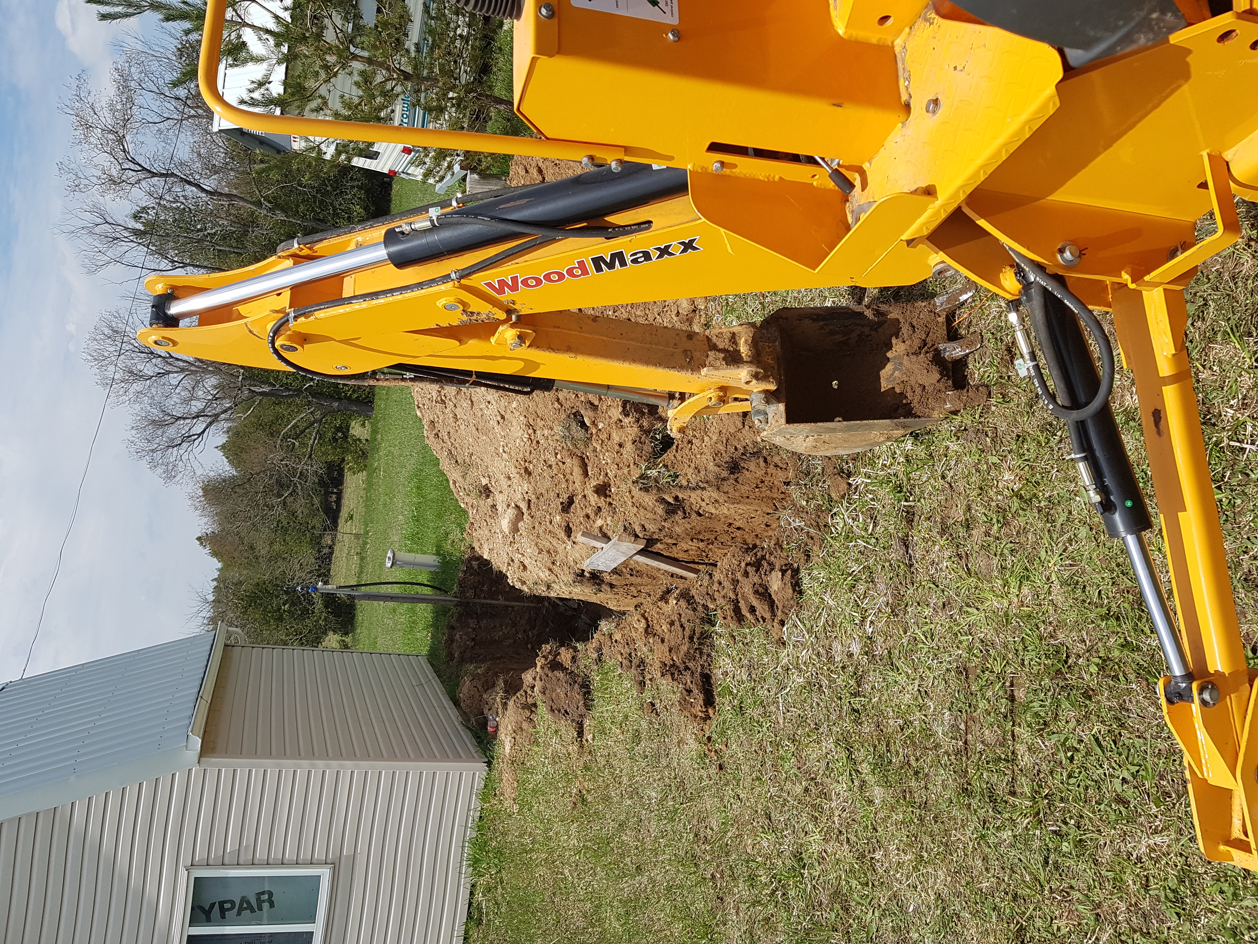

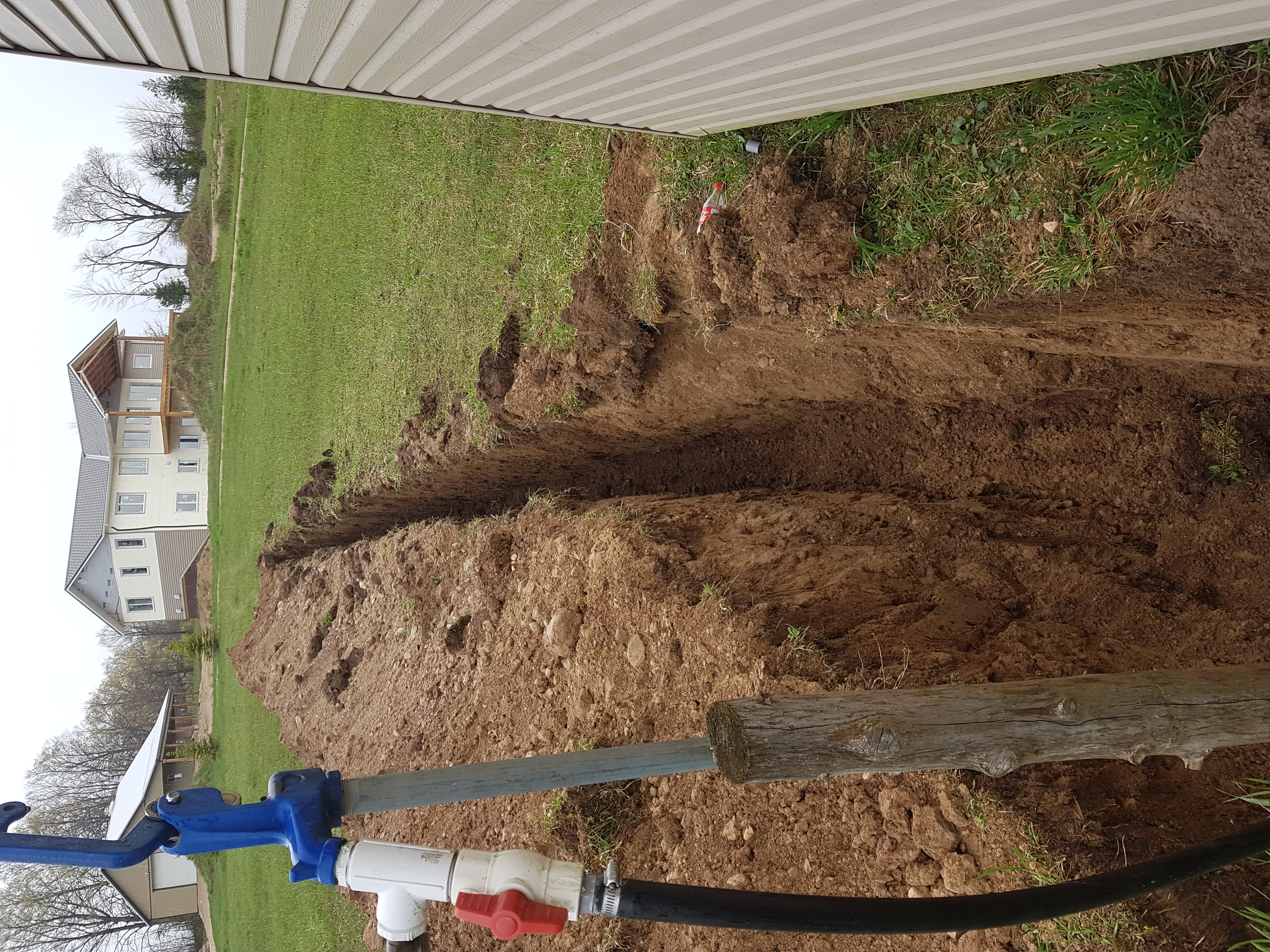

Two years ago we started building our home on a land purchased long time ago. This is our own project managed and build by us 99.9% in weekends and vacations. Maybe I'll start a thread about this in the future.
Anyhow, part of this large project I started digging the trench this weekend to bring the water from the well pump to the house side (250ft away). I did 150ft so far, 4ft deep and 1ft wide. 100ft more to go but that will be for next weekend. Was quite a challenge as I never used the backhoe on my tractor. Overall not bad other then movement of the hoe is not smooth at all. Anybody with a WoodMaxx backhoe to confirm if that is the way how should work? I bought it last year used, so this was the first time when I actually used. It has a PTO pump and I was keeping the tractor at 1700RPM.
I'm planning to put the 1.25" poly line and a conduit with all the wires for pump plus to bring 110V power to the shed.
Here are two pictures.

The PTO pump may be over GPMing the smallish cylinders. Try dropping the RPMs and see if that does you any good. If that drops the pressure too much, resulting in low digging power, you can add an orifice fitting. That will restrict flow but keep your pressure.
The pics don’t match the write-up. I was expecting something that looked like it was dug with hand grenades- the photos look good!

Being that it's the first time your using it, I think it's more operator learning curve. The first time I used the BH on my SCUT, I was all over the place controlling it. The controls need to be "feathered" lightly to place the bucket. Digging down or towards you, not so much, but side to side is a challenge. Practice, practice, practice.... Go slow, get the "feel", it will get much better.

OK, I wasn't sure about an aftermarket unit with a separate pump, so I held off. But considering the first two replies, I'll add in that higher RPMs on mine make the BH controls MUCH more responsive and 'jerky'. Most troublesome for me is the swing motion when in tight spaces. I've almost banged the bucket into things a few times. I have to keep the RPMs down a bit (1800 or so on mine) to minimize the sudden movements while still giving me decent working speed. I'm still working on figuring out how much stick to give it to do what I want without doing what I don't want.
Experiment with different throttle settings and practice, practice, practice.

The boom raise/lower on the new to me Ansung BH760 is super touchy. I can feather the control a little but a tiny bit more motion and the boom jerks suddenly which slams the tractor up or down. The other controls are not as touchy. I added adjustable restrictors on both ends of the boom cylinder. That's completely eliminated the jerks.
My being new to operating a backhoe certainly is a factor in my klutziness but the restrictor hack sure helps.
That trench doesn't look bad at all.
