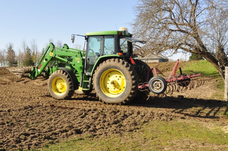

Hey guys I'm planing on building another tree spade this time for the John Deere tractor/loader.
I want it to spade a 50" rootball:thumbsup: give or take a few inchs
The tractor that I have is a 85hp JD:D -6400 and I beleive the back end weighs more than the front end.
This makes me wonder where to mount the spade on the front loader? or on the 3ph.
Any thoughts on this are apreiciated.
Thanks
Old Pipe.

Thanks for that Information and chart, It will be usefull.
I think now I will be building a 38" to 42" spade....and run it from the loader
