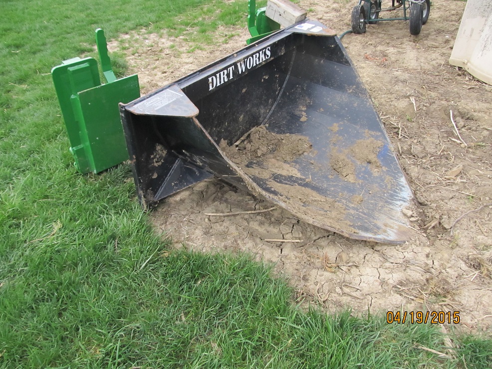

I have a tree "shovel" that is just a big pointed scoop that normally is used on a skid steer. I use on a tractor and it's a cheap way to transplant trees. it's not as exact as a tree "spade" that has multiple digging blades but I can do a lot in a hurry and no big investment or storage issues. Plus I can scoop up big rocks or other things easily.
A tree spade takes two people to use if you want exact digs or you have to keep hopping off the tractor to cut roots or guestimate where the thing is centered on the tree. In a perfect world I would like one but after the few trees are dug it's just a giant dust bunny.
Here is mine. The green thing next to it is an adaptor to go from Deere quick attach to SSQA that the shovel is.
