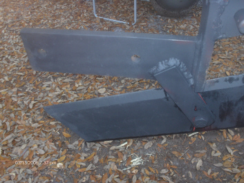

This is a hydraulic small tree cutter That I built from parts that I had. It is 3/4 in thick 6 in wide steel. The long steel piece has a knife edge. and the top has a flat edge. I can cut in any direction by pulling the unit off the 2 in box steel and reposition, It can cut vertical, horizontal, and upside down for some root cutting. It can cut about 4 in at the tip. Right now it is mounted on my forklift frame, and can be extended with an adapter. Don't know how high I can cut at this moment in time. I will experiment further. These parts can be acquired for around $200.00 the ability to weld is a plus. The aux control valve gives me the hydraulics.

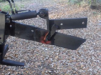

Another picture.

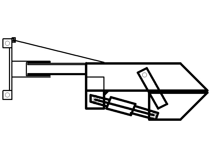

This is a TuboCAD drawing.

Bob, this does plug into a 2 in receiver, I made an L adapter to position it to most any direction. With an extension, it could be lifted up into trees to trim limbs.
