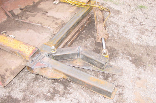

Howdy! FINALLY got to work on building a tree shear! Don't have it 100% done (or Painted!), but it was close enough to test it out on a few Western Red Cedar trees. Cut several 6"+ with ease. It's mounted (or WILL mount!) on the FEL of my IH 460. I scrounged all the parts (including the FREE cylinder). Spent $45 on hoses and fittings - otherwise it was free. Just couldn't afford the $1200 bill to buy one. Now to wage war on the scourge of the western world......

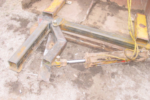

another view

Hey - great looking machine! I've got this one mounted on the bucket of my FEL for now. I'm hoping to trade for a different tractor/loader so will wait until then to make it fit whatever loader arms I end up with. I snipped a bunch of 6" - 8" cedars this morning with it. Beats the heck outta a chainsaw. I just snip and let lay. I'll come back later and push them up into a pile with my 8N. This part of the country (Nebraska) is infested with western red cedars - I'm hoping to get as many as I can out of the pasture so there is room for Cattle!

It looks great!
How do you control the direction of the tree when it falls?
How big of a tree can you cut? I guess the amount of preasure you pump puts out and the size of the cylinder decide the amount of preasure you have, so I'm curious of what you used in case I make one myself.

The trees I go after are usually 8" and smaller in diameter, 10-12 feet high at the most. The snip cuts them rather "unviolently" (sometimes I can't even tell they've been cut!) and they fall toward the stationary blade (to the right). I have it mounted on the front of my FEL so the bucket keeps the tree from falling back to the tractor. Used grader blade bits work great for blades, and most county shops (around here anyway) give them away for free, or next to free.

I used a homemade tree shear built by a university once on my JD 5300. The shear seemed to be very well built with 2, 5" diameter cylinders and 6x6" main beam and heavy shears. It just could not hold up to repetitve use. Imho, I don't think the one Dauchsund built is going to make it for long unless you use it on only small trees. I don't think your stop plate/mount is strong enough. Also if the closing shear gets a little out of alignment, it won't cut well. Not trying to discourage you, but my brother is a state forester and has seen a lot of underbuilt treeshears. The closing cylinder can make 10's of thousands lbs of pressure.

On a cedar, if you cut it and don't leave any branches, the stump and roots will die. No need to pull it out of the ground, disturb the adjacent grass and leave a hole. Also it is hard to pull a 6" or larger tree out of the ground. It always amazes me how trees in mountainous, or rocky regions, people can push or easily pull out trees. It doesn't work that way in the midwest. I can hook my large, MFWD, ag tractor (245 hp) to a 8" hardwood and not pull it out of the ground. I can pull a larger cedar out because the roots are more shallow. Can't push a ceder out of the ground easily in the midwest beacause they will break or bend before they root pops out. Pulling out a lot of trees just takes too long.
